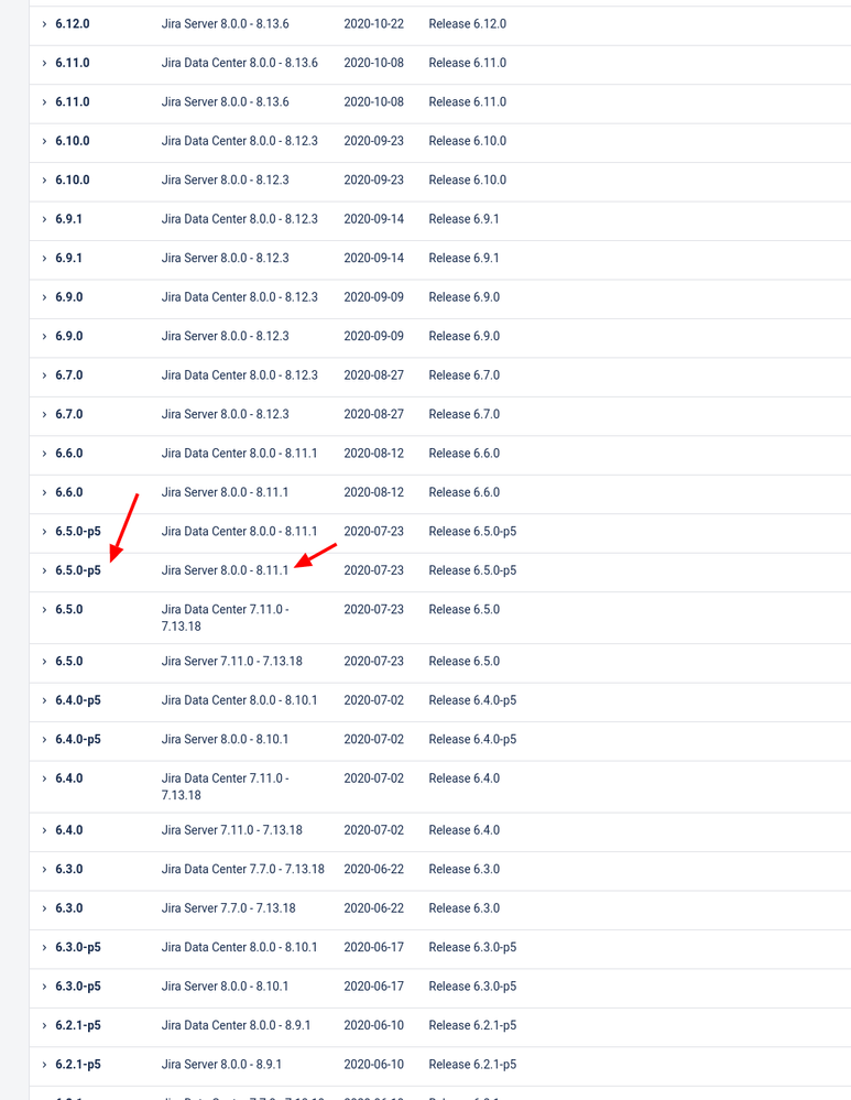

After going through your description, the first question I would ask is why you are still using ScriptRunner version 6.5.7 even after you have upgraded your Jira instance to 9.7.0?
ScriptRunner 6.5.7 is only compatible with Jira until version 8.11.0. Below is the compatibility list for ScriptRunner 6.12 and below:-

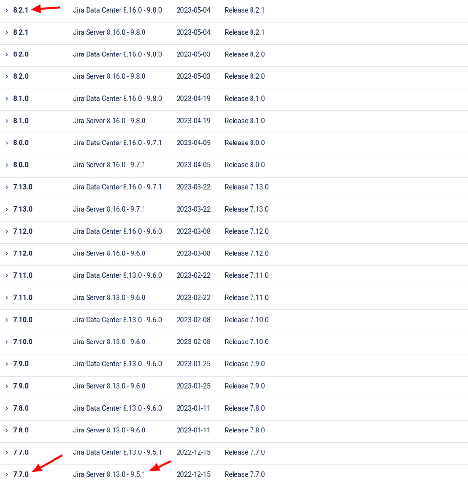

You need to upgrade your ScriptRunner to at least 7.7.0 to get it to work with Jira 9.5.0 as shown in the version compatibility screenshot below:-
Please upgrade to the ScriptRunner, i.e. 8.2.1 to be able to use the new features like HAPI for other bug fixes.
