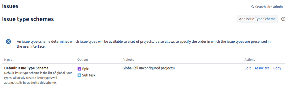

I am following this guide in order to enable sub-tasks:
https://confluence.atlassian.com/adminjiraserver072/configuring-sub-tasks-828788265.html

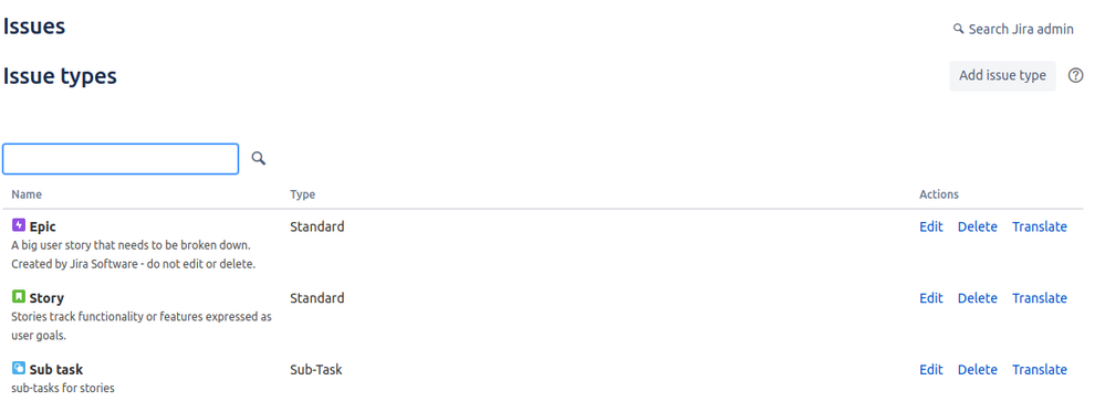

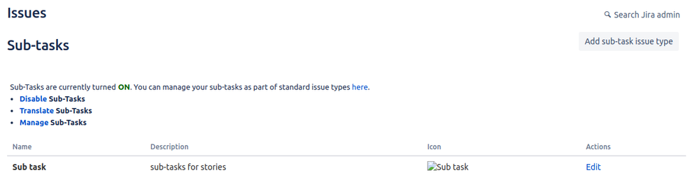

I have enabled sub-tasks, created sub-task issue type and it's present in my issue type scheme.
It's also part of my project's issues types:

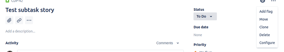

However, I cannot find the option `Create subtask` in the desired story.

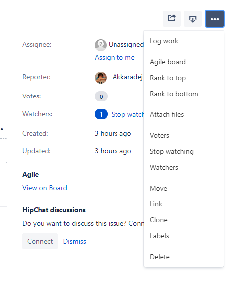

When I click the 3 dots in the right side, I get this menu: [Add flag,  Move, Clone, Delete, Configure]

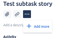

When I click the 3 dots near the icons `Link issue` and `Add attachments` I get only `Add More` which leads me to the marketplace (which has some PAID sub-task relaed add-ons).

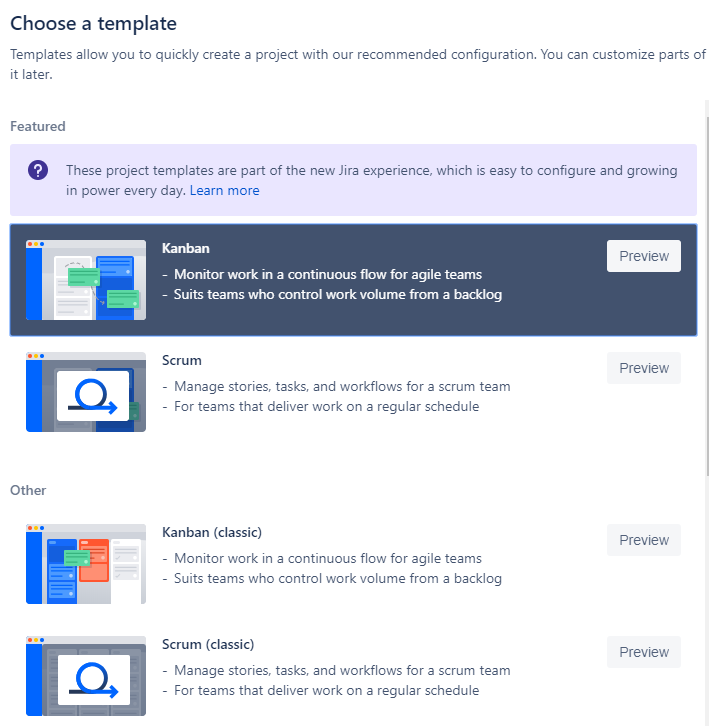

As @toffee mentioned, if choosing Kanban classic the option is available.
To solve my problem I've created a new project using that template and moved all the issues there.

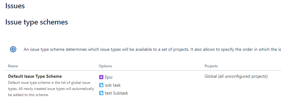

Ok, that's even more simple - you don't have any sub-task types in this project's issue type scheme.
toffee
September 13, 2018
I have sub-task issue type in "Default Issue Type Scheme" same as the topic owner.
Should I create a new scheme?
How to assign "Issue Type Scheme" to a specific project?

I was created project with new template, so may not work.
I think I should go with the classic template.
toffee
September 13, 2018
It's working with classic template!
Tanya Moldovan
September 16, 2018
So if I create a Kanban (Classic) it works. But why doesn't it work it Kanban project? How are we supposed to know the difference and why it is not documented?

Because you have not selected a project type that has sub-tasks by default.  All you should need to do is add one or more sub-task types into the issue type scheme.

I did add it - as described in the original question (check the screenshots). Everything is enabled according to the guide, but the option is not there

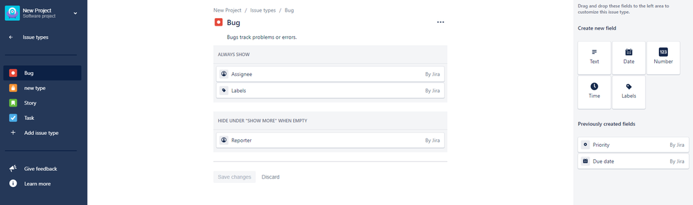

Have you enabled sub-tasks in the issue type scheme, or project settings if it's a Next-gen project?
Jonathan
August 5, 2020

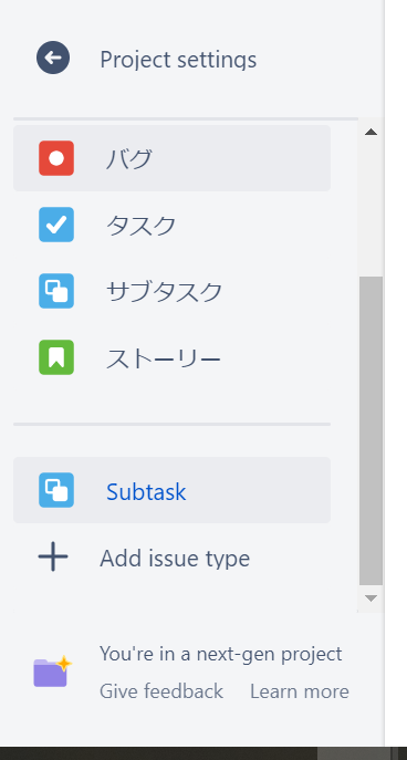

Hi, thanks for answering.
I just solved it now by looking into the project settings as you suggested and adding a new issue type of subtask.(didn't try that before, cuz there is alrdy a subtaskサブタスク in Japanese) Once I clicked "+ Add issue type" and added a subtask in English, the one on the bottom, I could start using child issues. I can now see the "add child issues" button on the top row of tickets.
I didn't create the project, so I think it might be something not configured properly by the creator.
Thanks for the help, jira is great :)
