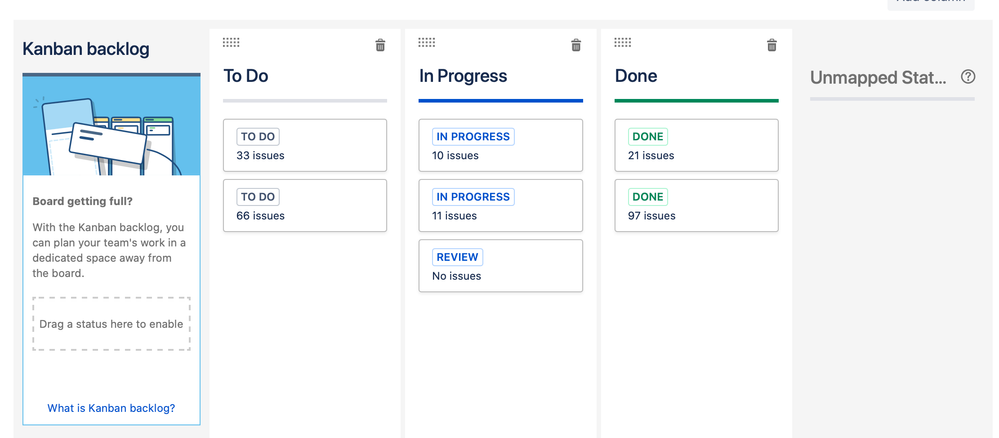

I'm not sure what you mean by backlog status, is there a specific setting somewhere for that? I thought that was the 'To Do' column/status...
Here's what the kanban column mapping looks like:

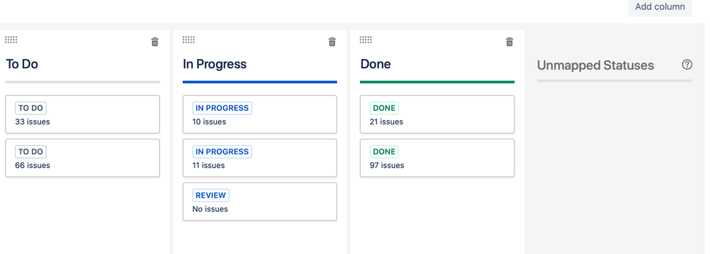

And here's the scrum column mapping
Paul Wieland
October 29, 2020
@John Funk  That bug you linked to seems to describe the exact problem I'm having. I guess I should not use next gen projects.
