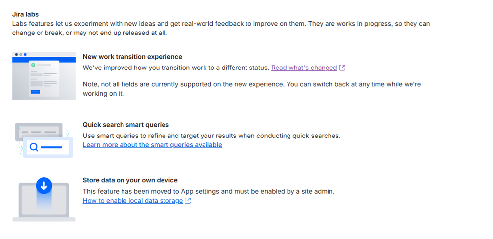

Bart_ Alex
May 20, 2026
I’d definitely stick with the old issue transitions. But once I’ve enabled it, I’m automatically switched back to the new issue transitions every two months. Previously, you could disable it, but now the buttons to get rid of these dreadful new issue transitions are missing. I can only recommend never enabling this...
/jira/settings/personal/general
