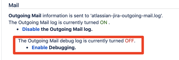

By default, the DEBUG log isn't enabled when mail logging is turned on. It's possible the errors you're seeing in the mail queue aren't triggering the level of alerting the non-debug logger would write.
On the Logging and Profiling page in Jira's administration, look for the Outgoing Mail section again. Indented under the outgoing mail log is a second section - for debugging.
Click Enable in that section to make sure debugging is enabled (this will write logging messages for all outgoing mail to the log).
Now on Jira's file system, you'll find that log in
<jira-home>/log/atlassian-jira-outgoing-mail.log
You should already see atlassian-jira.log in that directory. Once the logger writes something to the mail log for the first time, it will create the outgoing-mail log file.

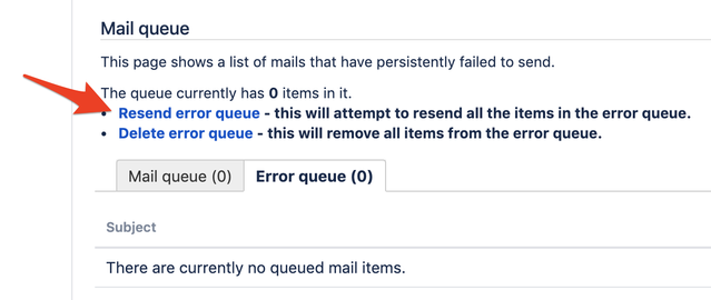

From the Mail Queue page in Jira, you can switch over to the Error Queue and click Resend error queue to have Jira try and re-process those emails. Since you've got debugging enabled now, info about these messages will be written to the outgoing-mail log file.
Based on the specific error you're seeing in the outgoing log, we can try to troubleshoot further!
