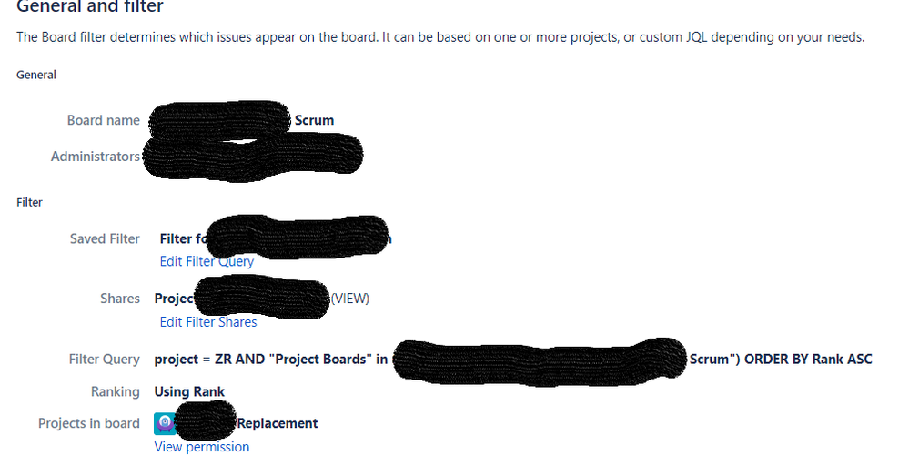

Hi Ash, I see 2nd and 3rd options and I created new scrum board using "Board from an existing project". Once I created new scrum board I don't see backlog items in new scrum board. Do I need to select Kanban board filter in filters or I am I missing some steps?
By rights it should bring everything into the backlog by default.
When you go to the board settings > filters - what does it present to you there?
By default your scrum board should be created with a backlog view with your items, which you can then start preparing in sprints.
In filter, I see multiple boards like Kanban and my new scrum board. So I selected scrum board( newly created scrum board). So do I need to select both scrum and Kanban board in filter option to show backlog items?
Apologies for the delay @Ram - a bit difficult for me to see with all the redacted items there but I think the problem may lie within the filter query.
Try removing the "Project Boards" filter, once again I'm unsure of the specifics here but if you're not seeing issues coming through that you expect, it would be in relation to the JQL written :)
