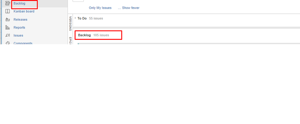

Hi Is there a way to display the 'not prioritized' issues at the top of the backlog. Currently the new issues appear at the bottom of the list and get missed :(

Thanks for the response Andrew. I am referring to the new backlog section in the Kanban project. I am unable to get the newly created tasks arranged based on priorities here (not sure how and where to apply the filter)
I am trying to get the 'not prioritized' issues (new ones) appear at the top of this backlog so that we don't need to scroll through all the issues to check for the new ones.

Hi Andrew, thank you! Yes, I am using the priority field for prioritization. The new tasks that are raised are appended at the end of the backlog. They don't appear on our board unless we explicitly move it to TODO just like on scrum boards.  I am trying to get these new ones (with priority = not prioritized) to appear at the top of the backlog list itself.
i.e items in my backlog do not appear on the board (only the ones in Todo and onward appear on the board). Just wondering isn't the quick filter specific to the board?
I am assuming you are suggesting to add the below JQL
<status = backlog and priority = Not prioritized>
in the 'quick filter' section of configure board
However I am confused about:
Will adding this as quick filter help in getting the 'not prioritized' tasks show up on the top of my 'backlog' list
Thanks a lot for your patience and for helping me resolve the problem :)
