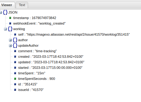

I am trying to implement action-based script, that reacts on multiple actions in Jira. Whenever an action happens, webhook is fired with info to my app, where I do the rest of the action.

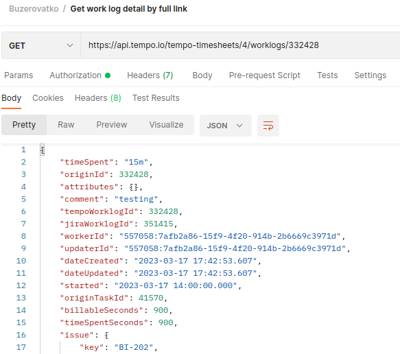

Used API URL with baerer token... It works fine for this one for example. Higher number brings "worklog not found or you dont have access". Even though the work log was just created and I literally get the API URL to supposed worklog.
https://api.tempo.io/tempo-timesheets/4/worklogs/330013

Thank you for your reply, at this moment I think I found out the problem.
From webhook I retrieve JiraWorklogId, not TempoWorkLogId. Which is little bit not expected, but I think I am going to be able to get over it and post the whole solution.
As you can see here, when I list all worklogs in given ticket, I can see that in fact I do not have tempo ID.
So I need to find relation in between jira worklog ID and tempo worklog ID. I hope that I can get ticket key. If I have it, then I can just list all worklogs and get what I need.
And with the tempo worklog ID, I retrieve real data without tempo timesheet. It is pain, but ... yeah, it is pain...

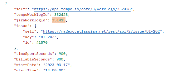

With Tempo API V3, you can see both jiraWorklogId and tempoWorklogId, but with Tempo API V4, you will only see tempoWorklogId. But you can still get jiraWorklogId with this endpoint on V4.
https://apidocs.tempo.io/#tag/Worklogs/operation/getJiraWorklogIdsByTempoWorklogIds

01) From webhook you retrieve data such as:
"https://our.glorious.domain/rest/api/2/issue/41570/worklog/351507"
and of course info about created_date and such.

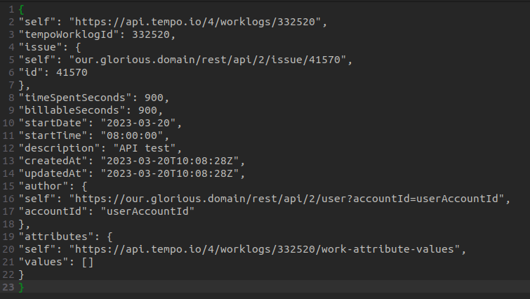

03) Last worklog there (with the same creation date as from the webhook) will be the one which I am looking for. This include the Tempo Worklog ID:

Since Jira does not track Tempoworklogid, it's not possible to use Jira API to find Tempo worklogs. So you have to get the list of tempo worklog ids first and then back track to find the matching Jira worklog ids. But your solution works well as you can get the data needed.
Just a side note that in the option #4, you are using a private endpoint to get the details. So this endpoint is not documented and subject to change without advance notice. We would recommend you to use the public endpoint instead.
https://api.tempo.io/4/worklogs/332520
