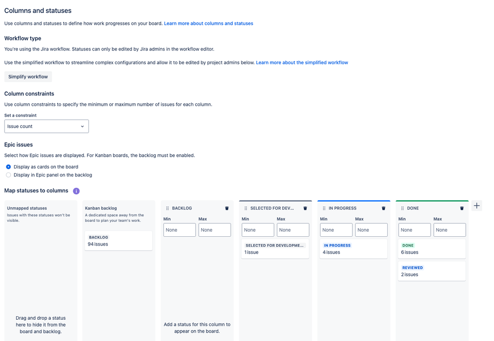

As @Stephen_Lugton mentioned the details of your board's filter would be helpful, as well as a screen image of the mapping of Statuses to Board Columns for your board configuration. That would be similar to this:

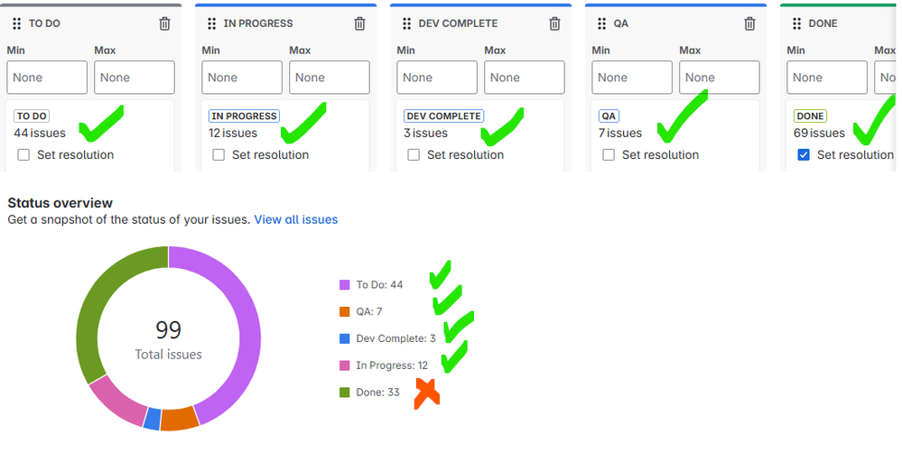

I discovered that the issue may have been caused by some tasks not having a "Team" selected, i.e. when the field was left empty.
The Kanban columns are now showing the correct number of issues. However, I’ve encountered a new issue where the "Status Overview" is displaying an incorrect count for column "Done". You can easily spot this by the reduced number of total issues (compared to the previous screenshot I shared), even though I have added more items to the board!
I don’t think this is related to filters, as I’ve already tried clearing them.
Trudy P Claspill
April 6, 2025
Hello @Mary
If you click on any of the Status shown in that donut chart it will take you to a list of issues.
If you examine the URL I think you will see that a timeframe filter is being applied. In my system I see this at the end of the URL
+AND+statusCategoryChangedDate+>%3D+-2w
Converting that to plain JQL =
AND statusCategoryChangedDate >= -2w
This appears to be applied to any status in your board that is in the "Done" Status Category, and it does not appear to be configurable.
Like Mary likes this
Mary
April 6, 2025
@Trudy P Claspill
Thanks for the quick response! Yes, I can see that in the URL.
Just to confirm: does this mean the time frame filter cannot be removed?
Trudy P Claspill
April 7, 2025
I couldn't find a method to change the chart on the Summary page to remove the timeframe component. I believe there are change requests open about being able to customize the page.
You could create a separate donut chart on a Jira Dashboard where that timeframe component would not automatically be added.
Mary
April 7, 2025
Thanks @Trudy P Claspill
I was using the built-in feature as it seemed to be the easy option! I might need to explore creating the chart separately on a Jira Dashboard if that’s the only way to avoid the timeframe component.
Trudy P Claspill
April 8, 2025
That is the only way to avoid the timeframe component since it is not possible to modify the Summary page at this time.
If my responses have adequately addressed your questions, please consider clicking on the Accept Answer button to mark your Question as Solved.

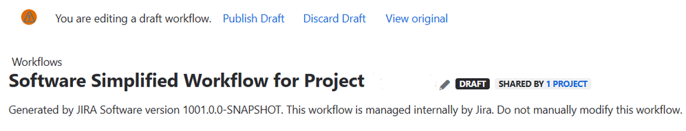

  • Initially, when I added issues, they automatically appeared in the correct columns. However, I attempted to update the workflow by adding a QA column using the + button on the right-hand side of the table. Later, I was also able to add a Dev Complete column from the ellipses (three dots ...).
  • I’m not sure if I was supposed to edit the workflow, as I later saw a warning message (screenshot attached).

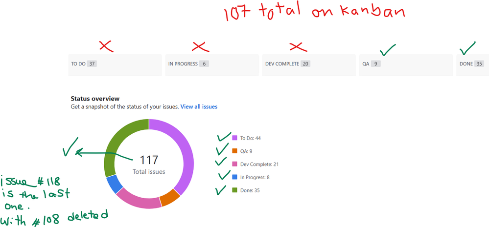

  • Now, the Summary page displays the correct issue count, but the Kanban board does not align with the same numbers (screenshot attached).
Let me know if you have any insights on this. Thanks again!
