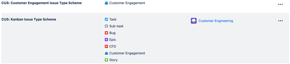

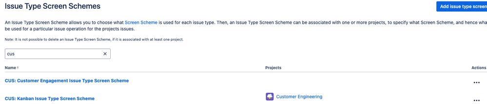

I Created a new Issue Type Scheme for a project (CUS: Customer Engagement Issue Typer Scheme) as is shown in the below image. The issue I want to use (Customer Engagement) for the new scheme already has a Issue Type Scheme Assigned.
If I remove the issue type from current Issue Type Scheme (CUS: Kanban Issue Type Scheme) will affect current issues?
Also I want this only affect the "Customer Engineering" project, it is required or not associate the project to the new Issue Type Scheme?
All this is triggered due we need to have a different screen for this issue type and not the same as we currently have. I already create the new screen, the screen scheme, and the Issue Type Screen and associated all among them.
Yes, that will affect the Customer Engineering project. The Issue Type Scheme specifies which Issue Types will be available in the associated project(s). A project can have only one Issue Type Scheme associated to it. If you remove the issue type from the CUS: Kanban Issue Type Scheme then that will remove that issue type from the Customer Engineering project. When you remove the issue type from the scheme, while that scheme is in use by a project, the process will force you to specify a new issue type to which any existing Customer Engagement issues in that project will be converted.
Since a project can have only one Issue Type Scheme at a time, whatever Issue Type Scheme you want to associate to the Customer Engineering project must include all the issue types you want available for that project.

If the problem you are trying to solve is having a different screen for the Customer Engagement issue type within the Customer Engineering project, you don't need to change the Issue Type Scheme. You should only be updating the Issue Type Screen Scheme.
It is the Issue Type Screen Scheme that associates issue types to Screen Schemes for a project.

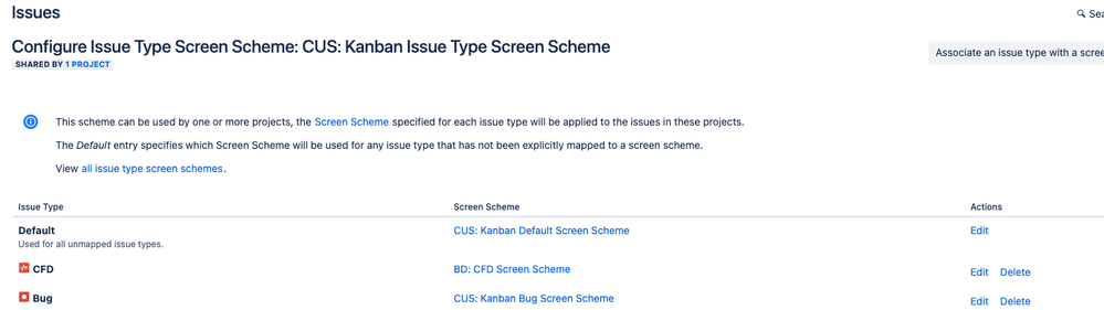

I just tried but I do not see how to change the screen only for customer engagement issue type.
What I've done:
1.
2.

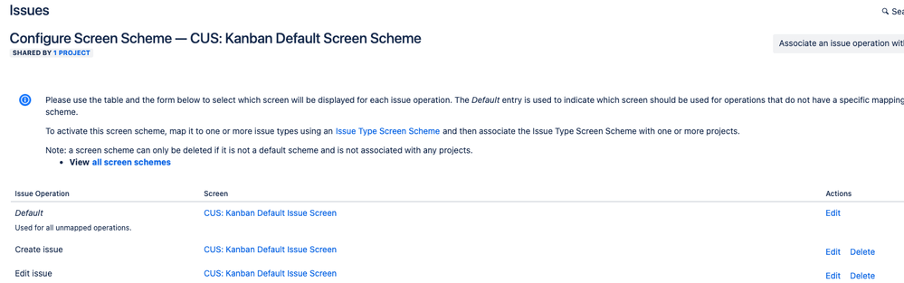

3. I press over "CUS: Kanban Default Screen Scheme"
Then, honestly, I do not know what next because if I press over "Create Issue -> CUS: Kanban Default Issue Screen" I see all the fields that are currently on use, so I do not know if I modify this fields will affect to the other issue types associated to this scheme

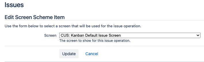

If I press over "Create Issue -> Edit" I see the following screen and I don't know what to do

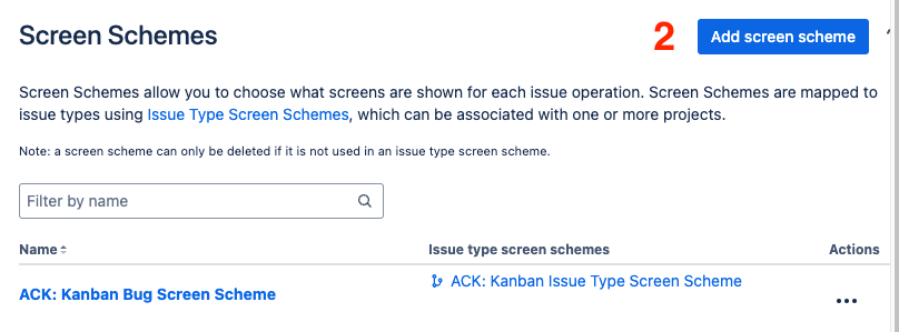

  1. Go to the Screen Schemes admin screen.
    https://your-base-url/jira/settings/issues/screen-schemes

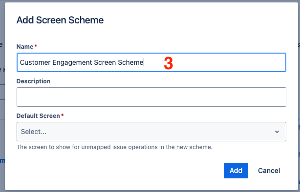

  2. Click the Add screen scheme button.
  3. In the pop-up enter a Name for your screen scheme; i.e. Customer Engagement Screen Scheme.

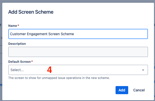

  4. For Default Screen select the screen you created in Step 1: Create the screens
  5. Click the Add button to save the Screen Scheme.
  6. If you have created different screens for the Create vs. View/Edit operations for the Customer Engagement issue type, modify this screen scheme to associate the appropriate screens to each operation

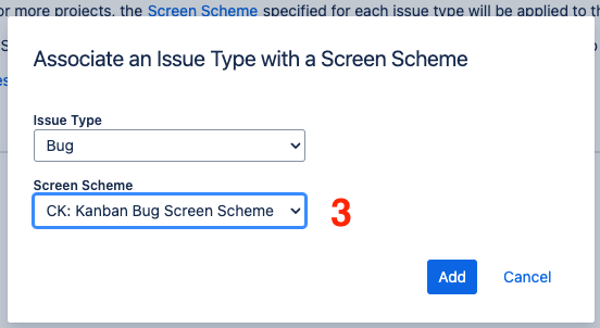

Step 3: Modify the Issue Type Screen Scheme "CUS: Kanban Issue Type Screen Scheme" to associate the Screen Scheme from step 2 to the Customer Engagement issue type.
https://support.atlassian.com/jira-cloud-administration/docs/manage-issue-type-screens/

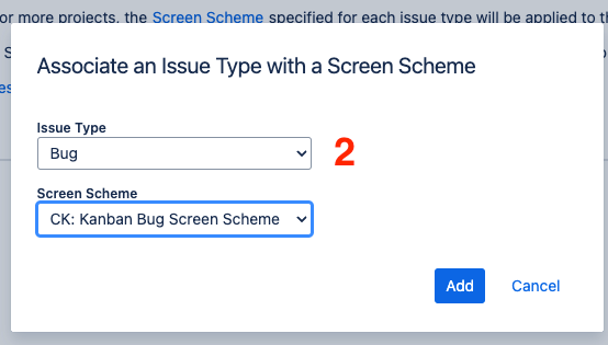

  1. Click the button Associate an issue type with a screen scheme
  2. In the pop-up select the Customer Engagement issue type
  3. Select the new Screen Scheme you created in Step 2: Create a Screen Scheme
  4. Click on the Add button to save the change to the Issue Type Screen Scheme.
