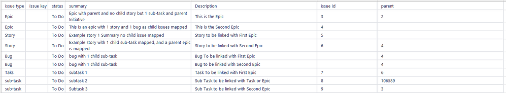

I have a requirement ,some example given below
I have to create a new epic ,Bug Tasks and Sub Tasks newly and link them each other properly
I would need a working template ,in the above what is the change i would need to do in csv file and the setting to be done in JIRA to do this import properly .Aim is to create everything one by one and link them properly .

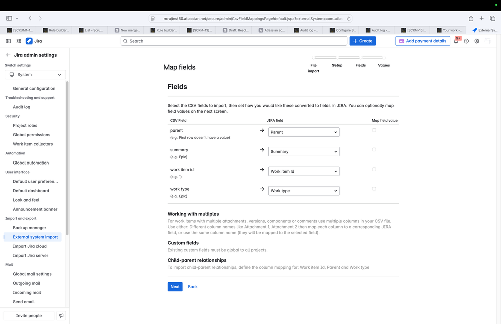

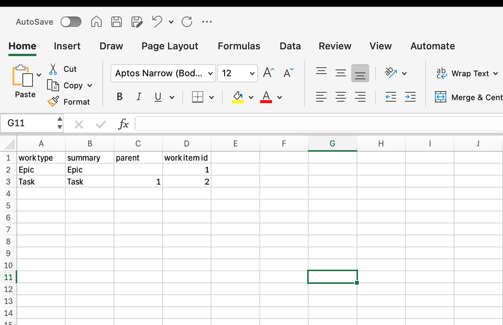

Hello, Good day. Please use the following format.
Screenshot 2025-05-22 at 7.54.05 PM.pngScreenshot 2025-05-22 at 7.55.07 PM.png
Mohanraj Thangamuthu
May 22, 2025
Confirmed on my test instance.

As this JIRA is in project managed and not in cloud , your given tags and my system fields not matching , tried your update ,not working ,
Few errors : Task not associated with Subtask
Epic name is required
only Task created no EPIC created , No linking done

This format is not working ; Very simple EPIC to Task Linking is required after it is newly created ; Please share the template i will try the same.
May 28, 2025
Thanks. Please create a Test Epic and a child issue under the Epic. After that export both these two issues to .CSV. You will get the format that is required to import the issues as well. Let me know if these steps help.
