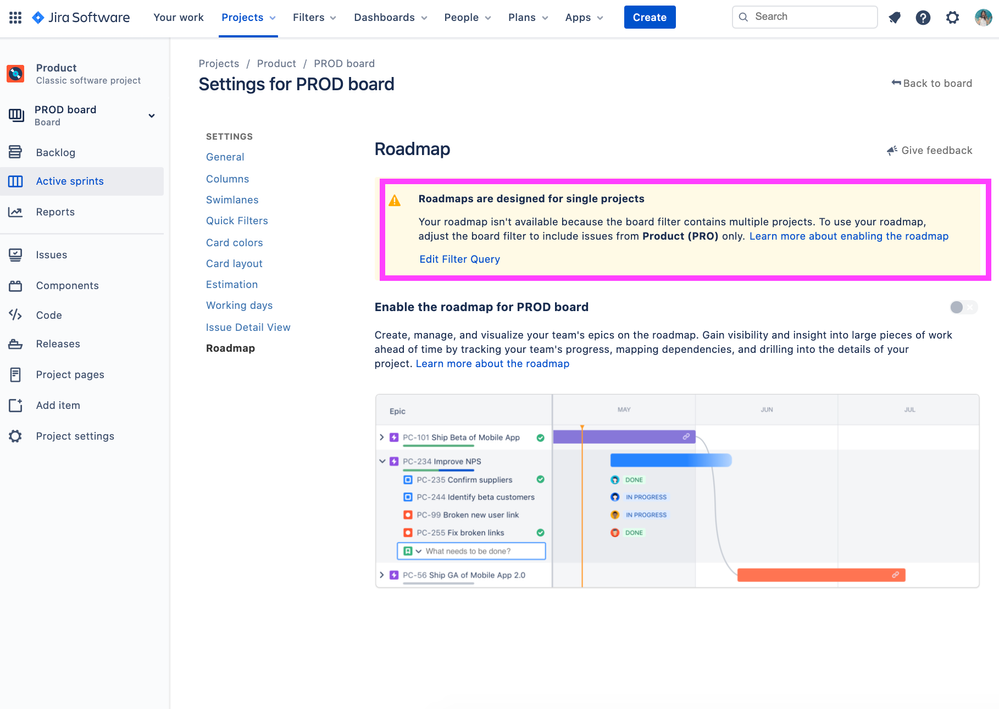

I am trying to set up the roadmap in all of my projects. However I have a wrong setting in only one of them. Can you help me figure it out?
This is the error I am getting

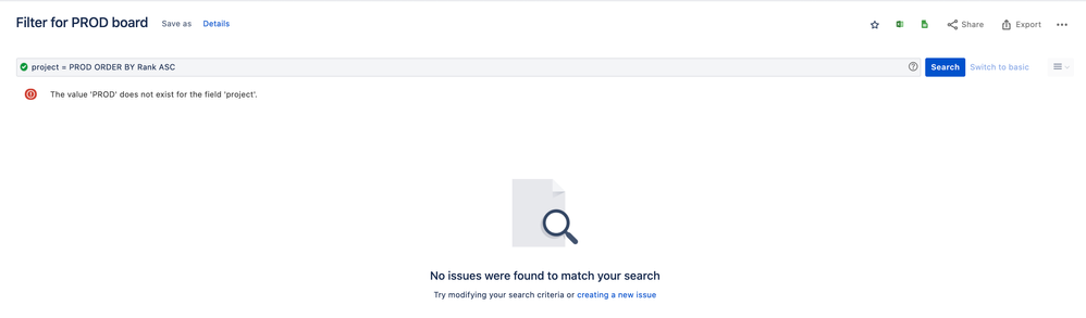

When I click on the "edit filter query" I land hereScreenshot 2021-02-05 at 13.35.37.png

Jack Brickey
February 5, 2021
Disclaimer,  I’m not using road maps at the moment. However, my guess is that your board is spanning multiple projects. This isn’t supported with roadmaps, it is meant for a single project. Check your boards filter to see if this might be the case.
Jack Brickey
February 5, 2021
Looking a bit closer it seems that the filter is a single project but to be sure click on the edit filter query and see what is there.

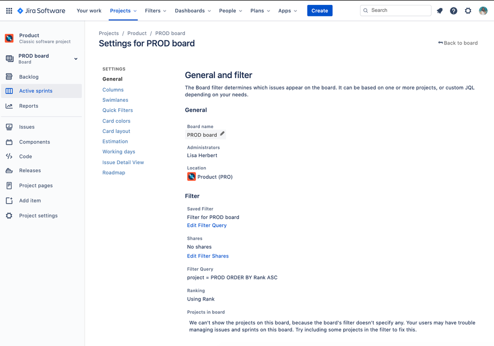

Please note the message at the bottom of the general settings page:
"We can't show the projects on this board, because the board's filter doesn't specify any..."

Jack Brickey
February 8, 2021
As Bill indicated it seems that the PROD project does not exist or has been archived.

lisa
February 8, 2021
It was indeed the wrong project linked.

Thanks for trying to help me but I am still super lost. If I go to "edit filter query" this is where I land...??? @Jack Brickey
@Bill Sheboy this project has not been renamed. The active sprint board does work too... any ideas?
