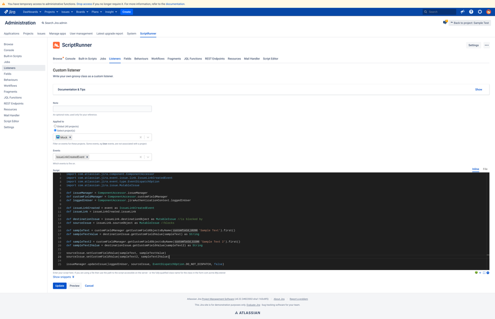

For your requirement, it would be best if you used the ScriptRunner Listener along with the IssueLinkCreated event.
Below is a sample working code for your reference:-

Below is a screenshot of the Listener configuration:-

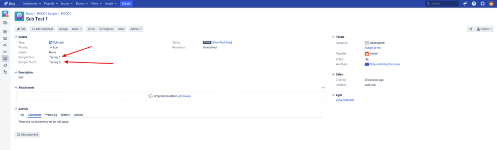

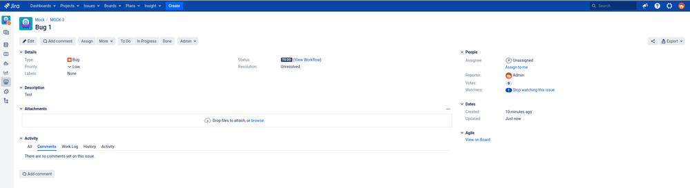

1. A Sub-task and a Bug ticket are created separately, as shown in the screenshots below. In this example, the Sub-task issue is a Sub-task to a Story. If you notice in the screenshot below, the text fields Sample Text and Sample Text 2 already have values for the Sub-task but not for the Bug.

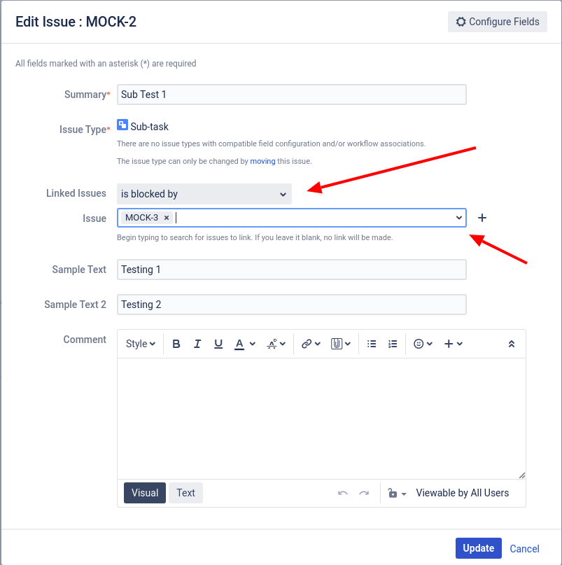

2. Next, the Sub-task is edited, and a link to the Bug issue is added, as shown in the screenshot below:-
The is blocked by link is used for the Sub-task. Hence, the Bug issue will have the blocks link.

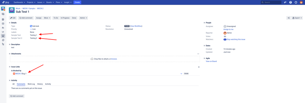

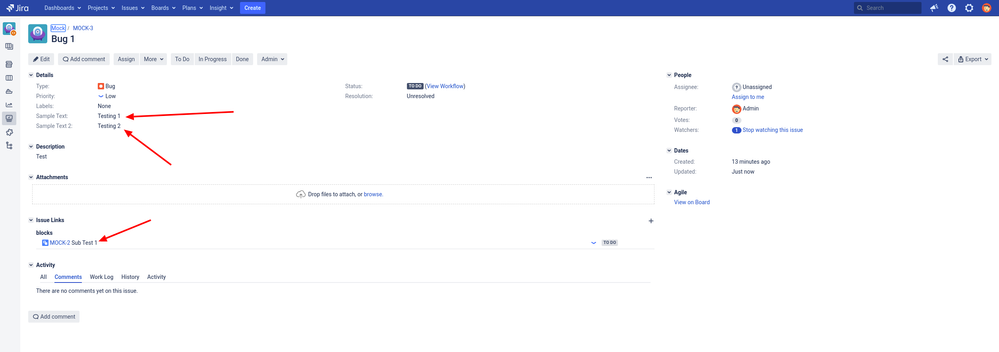

3. Once the link is added, the issues will be updated accordingly, as shown in the screenshots below. If you observe in the Sub-task issue, the is blocked by link is added. Similarly, the blocks link is added in the Bug issue, and the Sample Text and Sample Text 2 fields are updated in the Bug issue accordingly.
If you are to run the task in the reverse order, i.e. create the blocks link in the Bug issue, the result is the same.
