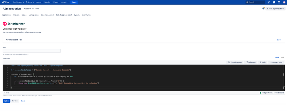

For your requirement, you need to use ScriptRunner's Custom Script validator, and you will need to modify your Validation code to:-
import com.opensymphony.workflow.InvalidInputException
def cascadeFieldNames = ['Sample Cascade', 'Hardware Cascade']
cascadeFieldNames.each {
def cascadeFieldValue = issue.getCustomFieldValue(it) as Map
if (cascadeFieldValue && !cascadeFieldValue['1']) {
throw new InvalidInputException("${it}", 'Both Cascading Options Must Be selected')
Please note that the sample working code above is not 100% exact to your environment. Hence, you will need to make the required modifications.
If you observe the code above, I have listed the names of 2 cascading fields in the cascadeFieldNames list for this example. In your case, you must add the names of all the 10 cascading fields you want to validate into the cascadeFieldNames list.
In my environment, I have added the validation to the Create transition. You will need to set it according to your requirements.
Below is a screenshot of the Validation configuration:-

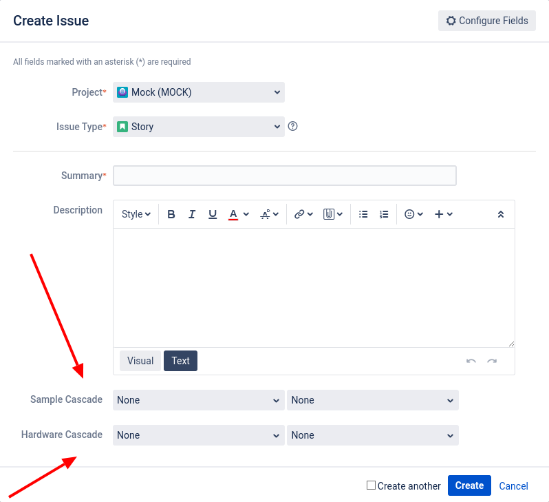

1. Create a new issue. By default, no value is set to the Cascading List

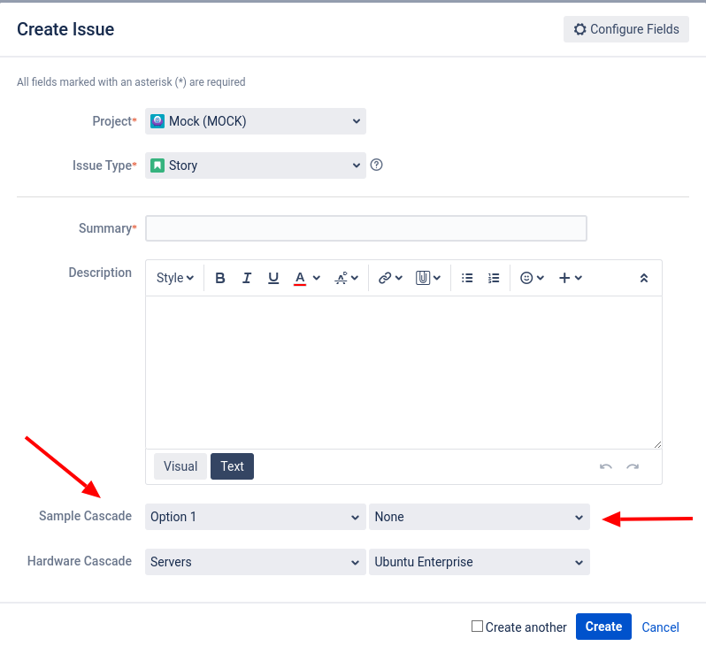

2. Set the values for the Cascading List. In the example below, only the parent value has been set for the Sample Cascade Field, and both values have been set for the Hardware Cascade field.test2.png

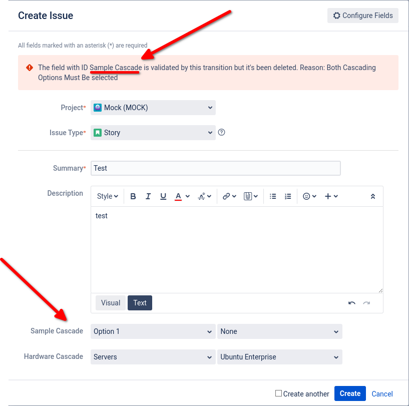

3. When the create button is clicked, the validator error message is returned since only the parent value from the Sample Cascade field has been set, as shown in the screenshot below:-

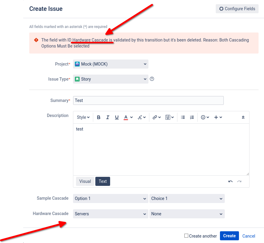

4. The test is repeated once again; this time, both parent and child values have been set for the Sample Cascade, but only the parent value has been set for the Hardware Cascade field; the validation error message will display the error on the Hardware Cascade field.
