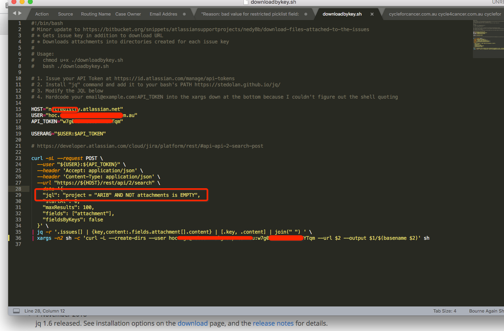

Im attempting to use it. Im not familiar with scripts and was wondering if you're able to help me get it working.
Have I got the correct values filled out?
Once I have the correct details do I just double click on it for it to run?
Where does it save the files in which directory?

@Hoc , if for some reason you're still interested in a response (or someone else with the same problem), I believe the likely issue with your screenshot is the presence of quotes around ARIB. You'd just want it to be "project = ARIB AND NOT attachments is EMPTY".
Once you have the correct details, you'll want to put this script in its own directory (e.g., 'Downloads -> attachments), open a terminal, navigate to that location (e.g., something like cd Downloads/attachments ), then run the command (without quotes) "chmod +x downloadbykey.sh"), and finally "./downloadbykey.sh" (again, without quotes). The attachments should appear in directories named after each issue key (e.g., ARIB-123). If you use my script, the attachments should have their original filename as specified in Jira; Darryl's script will name the attachments just as their Jira-internal attachment id number (e.g. 546793).
