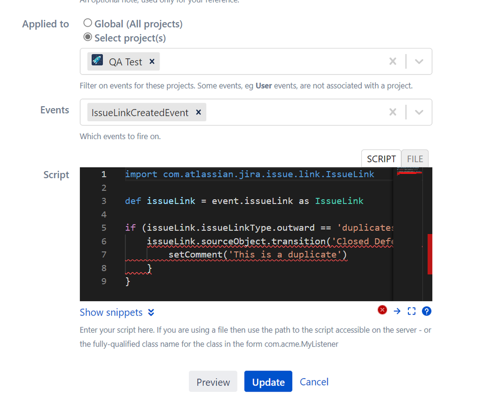

Garden16_
December 11, 2023
Getting static checking error .
The transition to close defect is the last transition. The issue link may be used at any different statuses. Is a transition required to close defect from all statuses
Garden16_
December 11, 2023
ERROR [runner.AbstractScriptListener]: *************************************************************************************
ERROR [runner.AbstractScriptListener]: Script function failed on event: com.atlassian.jira.event.issue.link.IssueLinkCreatedEvent, file: null
groovy.lang.MissingMethodException: No signature of method: com.atlassian.jira.issue.IssueImpl.transition() is applicable for argument types: (String, Script214$_run_closure1) values: [Closed Defect, Script214$_run_closure1@1aacbead]
at Script214.run(Script214.groovy:6)

Ram Kumar Aravindakshan _Adaptavist_
December 12, 2023
Hi @Garden16_
It seems you are using a very old and no longer supported version of Jira.
The .transition('Done') is based on ScriptRunner's HAPI feature, which is used to simplify the code.
You cannot access this in the current Jira and ScriptRunner versions you are using.
I suggest upgrading your Jira instance to at least 8.20.0 and upgrading your ScriptRunner plugin to the latest release, i.e. 8.17.0, so you will be able to use the new features.
Thank you and Kind regards,
Ram
Garden16_
December 13, 2023
Please share the code based my current JIRA version.
December 13, 2023
Hi @Garden16_
Unfortunately, with the older version of Jira and ScriptRunner, this is not doable via Listener.
You will need to use the Post-Function for it.
Ram
