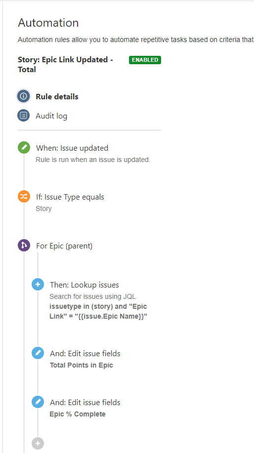

Okay, this (above) worked for my Epic % Complete field. Thank you! Here's my next problem, however:
This automation runs when a story is updated. When the story is updated to add an Epic Link, the story points from it are added to the field Total Points field on the Epic screen for the Epic it is linked to). This works great, except in the circumstances when someone changes the Epic Link on the Story or deletes the Epic Link from the Story. When that happens, the Lookup issues portion of the Automation no longer can find the Epic the story was assigned to (since it changed) so the story point total in the Epic remains at the same number even though the story is no longer linked to it.
I can fix this by going into one of the stories that is still assigned to the Epic and making any kind of update to the form, which triggers the rule and point calculation again. But when I try to automate this (add then remove a label to every story, for instance, via automation), the update to the issue doesn't trigger the rule calculation. Why does an automated update not work, but a manual update does? Any ideas on what I can do?
To clarify, I want to force an update to stories with Epic Links via Automation, but when I do things like add a Label or add a Comment to the story via Automation, that does not kick off the Automation pictured above. I don't understand why! If I make the same change manually to the story with the Epic Link, the Automation above kicks off.
Check the option:
"Check to allow other rule actions to trigger this rule. Only enable this if you need this rule to execute in response to another rule"
This option can be found in the rule details.
THANK YOU!!!!!!! I can't believe how much time I wasted. You're wonderful!!!!

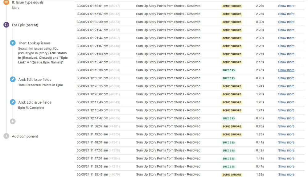

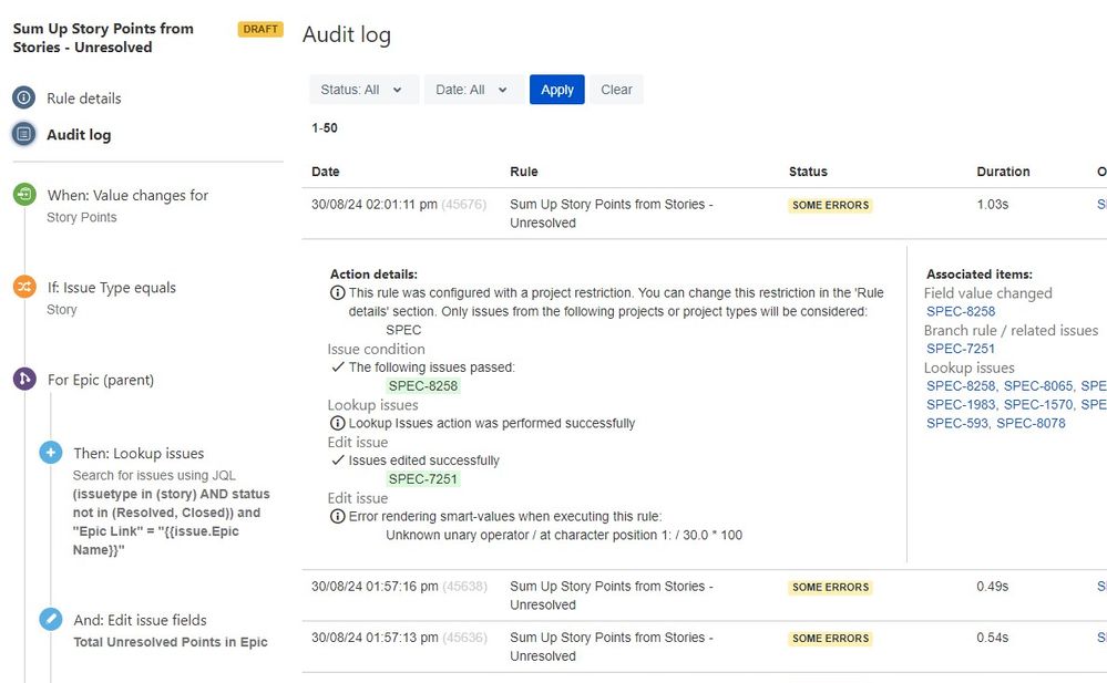

@Marc -Devoteam- I'm hoping you can help me. My automation using
{{#=}}{{issue.Total Resolved Points}} / {{issue.Total Points}} * 100{{/}} works in some cases, then does not. I'm getting this in the Audit log when it does not (see screen cap). Any ideas? What is strange is that it sometimes works (see second screen cap).
This will occur when you have the incorrect smart value for the field, as it becomes an empty/null value in the expression.
So if the field has no value, this can occur.
You could set your calculation like this:
{{#=}}{{issue.Total Resolved Points|1}} / {{issue.Total Points|1}} * 100{{/}}
The the field always has 1 as default in the calculation, if the field is empty in an issue. When performing the automation.
You are correct again! My Automation to calculate the Total Resolved Points was entered in a way that after the result was calculated I set the automation to clear the field mistakenly! I just had to fix that and it all appears to be working now. You're so wonderful!!
