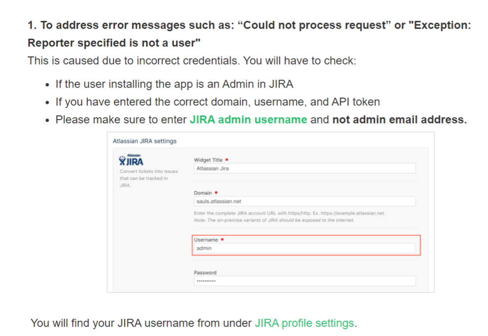

Katie Kokkinos
March 9, 2021
Hello Dario,
I appreciate your reply. Please note that I am only trying to follow the instructions that I have been given. See below screenshot from my Freshdesk account. It explicitly states that I need a username and not an email address.
Best, Katie
Dario B
March 9, 2021
Hello @Katie Kokkinos ,
I believe I have found the documentation you are following and it seems indeed to be either a mixed Cloud/Server doc, or just something a bit outdated.
The links I have found are the below ones:
And in there I can see that the link in the third bullet point (quoted below) is pointing to a documentation page for Cloud (that is not mentioning usernames at all, since they have been removed: https://support.atlassian.com/jira-core-cloud/docs/add-new-users/ ):
While the link in the last sentence points to a documentation page for Jira Server 6.4 instead (https://confluence.atlassian.com/jira064/managing-your-user-profile-720416077.html - Jira Server and Data Center 6.4):
 You will find your JIRA username from under JIRA profile settings.
