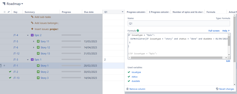

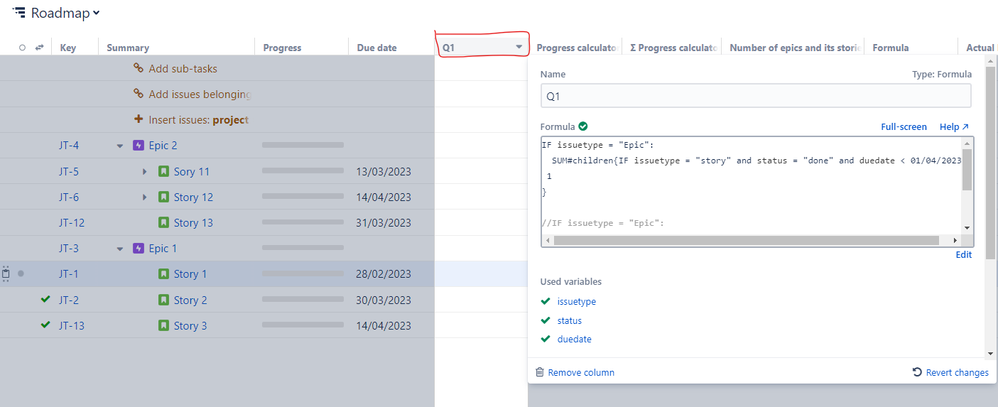

Here is what I have:
IF issuetype = "Epic":
SUM#children{IF issuetype = "story" and status = "done" and duedate < 01/04/2023:
1
The above I am using to show number of story completed whose due date on or before 31/Apr/2023.
 SUM#children{IF issuetype = "story" and due_date < 01/04/2023:
 1
This is used to show total number of story under epic whose due date on or before 31/Apr/2023.
when adding due date to the formula it doesn't show any data. Screenshot 2023-03-14 163257.png
changing the due date from duedate < 01/04/2023 to duedate > 01/04/2023 shows under epic one. don't know how due date works with formulas and not sure how I can display the results 23/40 format or something like that.

I have understood you are saying that the formula seems to ignore the due date as it is just counting the first two critera of issue type and status, so, in your case, it counts two Stories in the Status but then disregards the date.
Typically for this type of coding, it is very important the formatting of the text, in this example they provide, you can see they are referencing the due date but you have to type it exactly as dueDate. Have you tried amending your script in this way?
