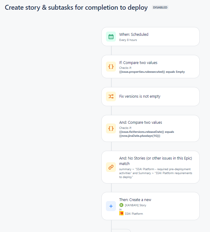

all of this works except the bold/underlined condition.
This rule will check all the fix version release dates on all the Epics, make sure the rule was not already actioned on it & then if they are within 16 days of the day the rule is run the it should create the story & subtasks for the use case team to complete to deploy
There is a lot of sub-task creation which is irrelevant,

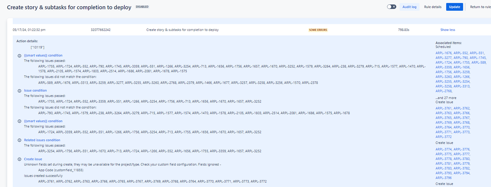

This is the part that is not working
image.pngas that part works, the below I think is what you all need for the full rule
It says it passed, but only ARPL-3359 should have past the last condition to be processed
as it is the only one with the correct release date to match my condition

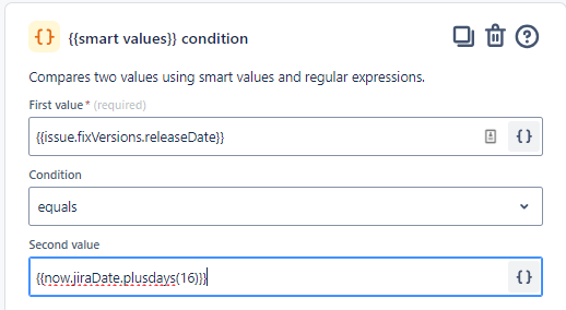

Looking at the rule, first thing I notice is that your smart value condition for fixversion release date needs tweaking.
Your syntax should be:
{{issue.fixVersions.releaseDate.jiraDate}} EQUALS {{now.plusdays(70).jiraDate}}
Because the way you have it, {{now.jiraDate.plusdays(70)}} is not correct and is resolving to NULL and so it is matching issues which *dont* have a fix version to it.
So please change the syntax and rerun the rule...

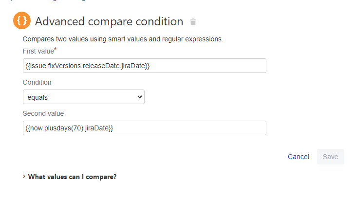

Kalyan Sattaluri
May 20, 2024
Should be like below:
