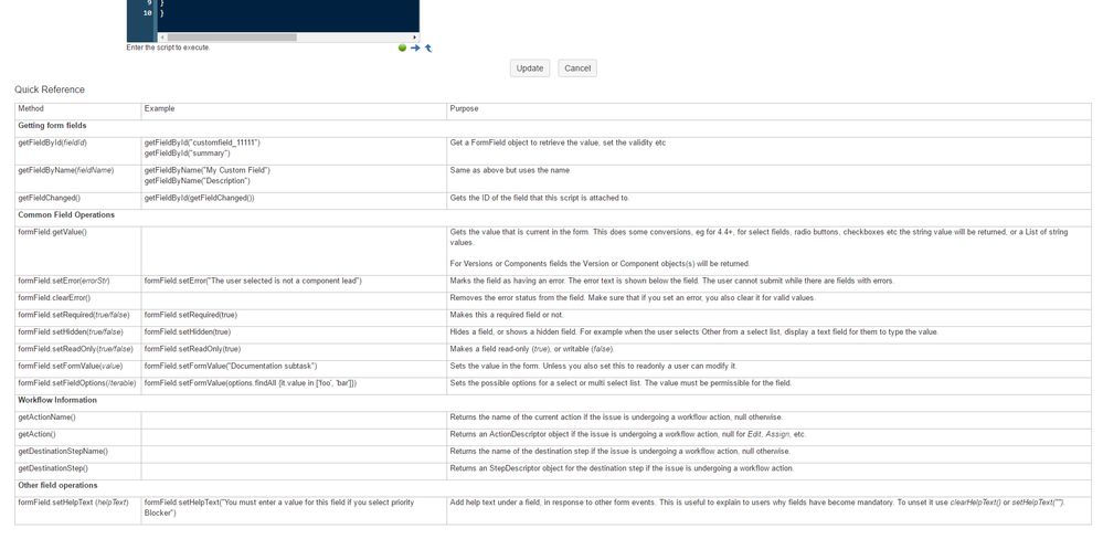

JIRA_Reference.PNGHere in above image can you please tell that which method will be helpfull for below task :
"We have 2 custom fields and we want to change the value of field 1 dynamically based on the value of field 2(For instance, when field 2 will have some value then field1 should be mandatory and if field 2 has no value then field 1 should be non mandatory).We need some kind of function in scriptrunner which is similar to  jQuery onChange() .Please let me know how this could be achieved ?"
Nic Brough -Adaptavist-
January 2, 2018
I'd use the getFieldByName and setRequired you found in the table of help.  It's good to read and learn new stuff.
