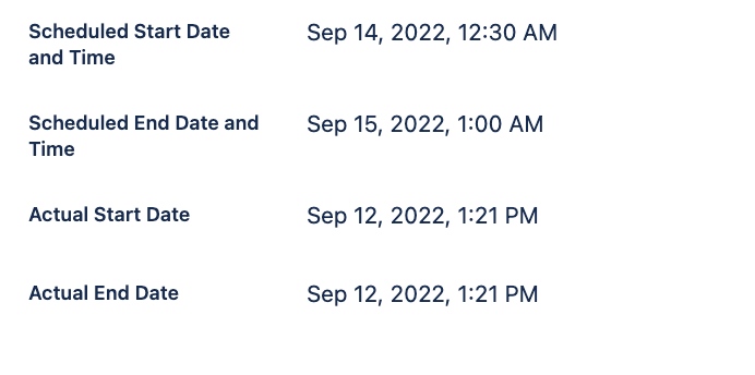

Saira
September 12, 2022
If you see Actual Start date ie is earlier than scheduled start date, this should not be allowed. I'm also setting Actual start date in post function when the user goes to In Progress. Not sure if that helps you analyze the problem

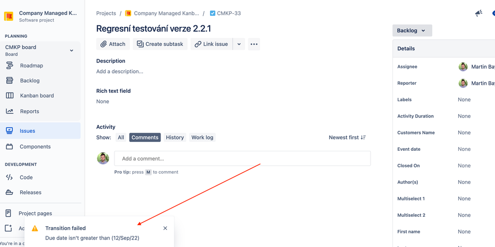

Hi @Saira , I just tested it on cloud and it works correctly for me. Did you publish your updated workflow? :)
Martin Bayer [MoroSystems, s.r.o.]
September 12, 2022
Hi @Saira , sure, the error message looks like:
But I think your configuration is wrong. Your configuration is
  • IF scheduled start date and time IS GREATER THAN now, than let the validation pass
If I understand it correctly, you need the oposite
  • IF scheduled start date and time IS LOWER THAN OR EQUAL now, than let the validation pass
Let me know if it works :)
