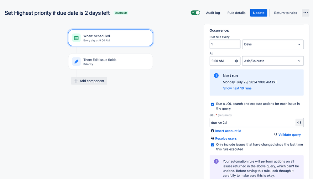

Hi @LBL , Create an automation rule using scheduled trigger, in the condition use Jql (due <= 2d) and use action 'edit issue field' priority and set to Highest.
Let me know if you have any query in setting up the rule. Thanks

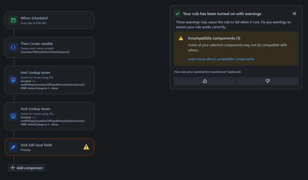

LBL
July 28, 2024
I used the similar template but it seem like not working

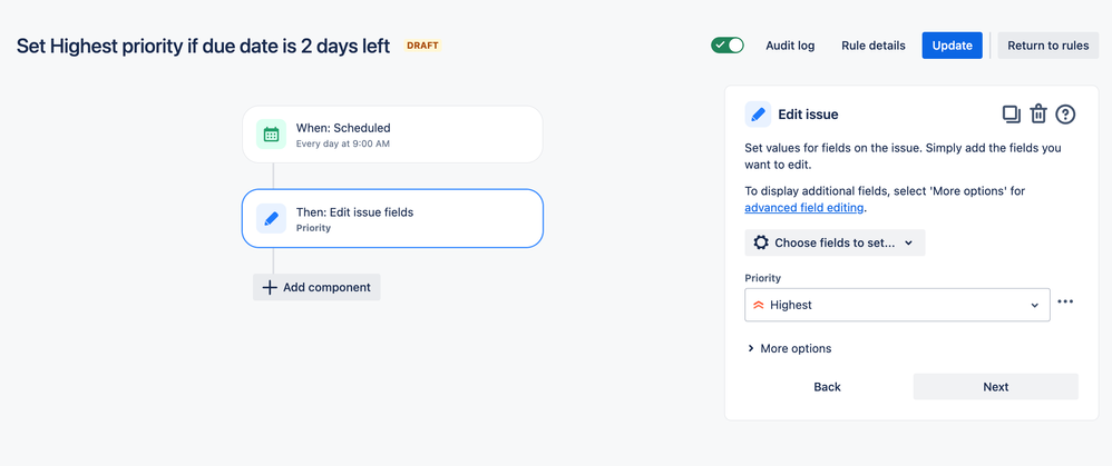

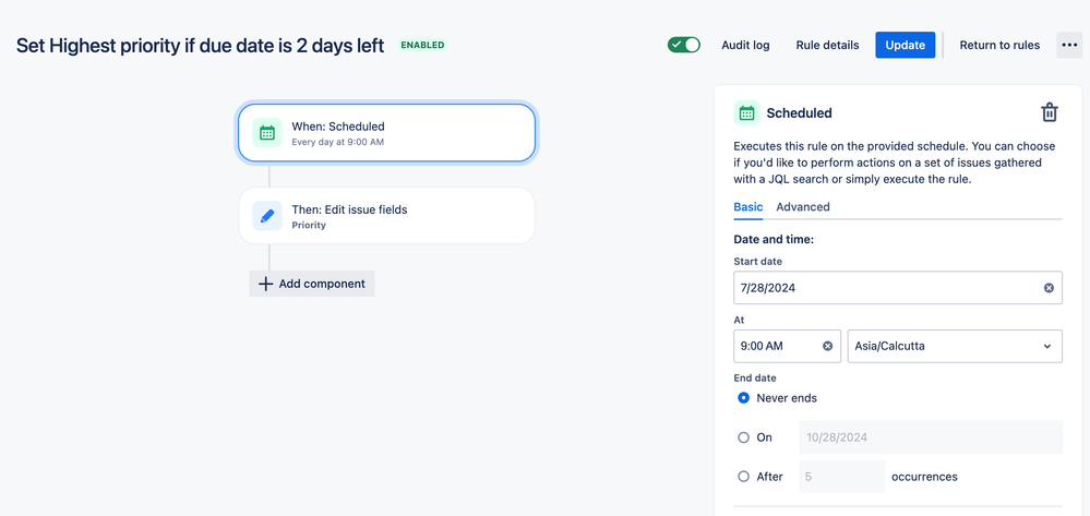

shib saha
July 28, 2024
Could you please share the exact requirement like it is for all the issue type in the project or only selected issue type? do you want to add any other parameter to cover the scope of the automation rule?
i see you have used other components too in the automation, are those required? that's why i want to understand the requirement first and then i can respond to your query accordingly.
if you simply want to change the priority of all the issues in your project when due date is 2 days left, create the automation rule as follow
Screenshot 2024-07-28 at 7.22.17 PM.pngScreenshot 2024-07-28 at 7.22.43 PM.pngScreenshot 2024-07-28 at 7.23.00 PM.png

LBL
July 28, 2024
@shib saha thanks for solution
i do exactlly what you said but this time, the rule did not do any action
then i change the code to: duedate >= now() AND duedate <= endOfDay("+2") and now it work
Thanks really much for your help, i've spend 3 days to find the rule

Bill Sheboy
July 28, 2024
Hi @LBL -- Welcome to the Atlassian Community!
Adding to the suggestions...
You may want to add to the Scheduled Trigger's JQL so it does not update the priority of any already completed issues:
AND statusCategory != Done
Kind regards,
Bill
Like # people like this
