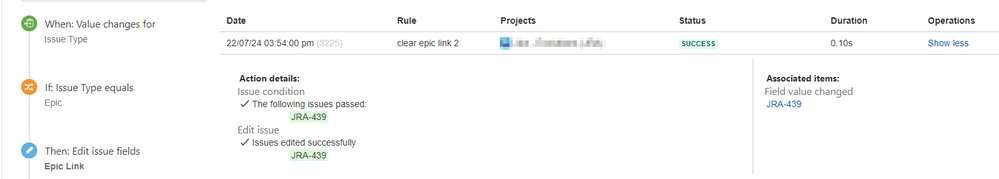

If you check the audit log, can you confirm that the success message looks as follows, adn that the datetime matches with the moment you moved the story ?
Aisha M
July 23, 2024 edited
@Antoine Berry  Yes, this is how the audit log looks for me too.

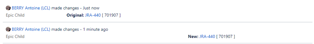

July 23, 2024
Yes, the automation rule is working correctly. See attachment history of the Epic, you can see that the story transformed to Epic is removed.Epic child removed.png
Are your Story and Epic created in the same project ? If so, please try to reindex the project, and, if not working, try a global reindex.
