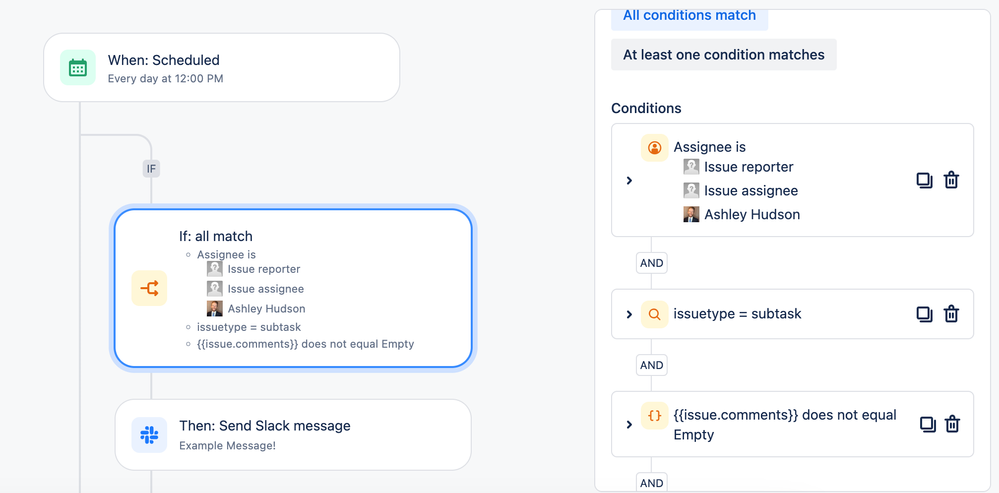

So you'd need to create an automation rule that looks like the following (for the example of an issue is assigned to a user: (Note that you can add as many users in this solution)

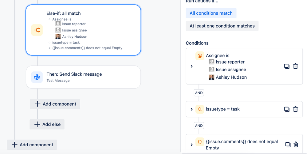

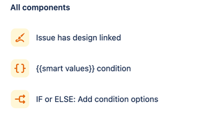

So to explain the automation rule: You would select the trigger to be a scheduled event for every day at 12pm (or whatever time frame you'd like) and then add an "IF or ELSE" event as seen here:
Then in the conditions, add the following as seen above. The condition at the middle specifies the issue type as mentioned, you would like two automations to catch if it's an subtask issue type or a task. The task solution can be seen below:
The last part of the Else-If is a smart value to identify if the issue comments is empty. Last add the slack message component and all should work for you!
