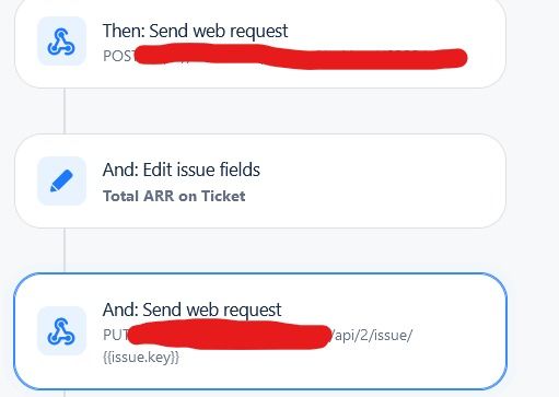

Hello!
Found this post while trying to solve a similar issue. I needed to update a multiselect field with the results of a query I have on Metabase.
This was how I handled it.
PUT request body:
    "fields": {
        "customfield_10151": [
            {{#webResponse.body.data.rows.get(0).get(1)}}{
                "value""{{.}}"
            }{{^last}},
Explanation:
{{#webResponse.body.data.rows.get(0).get(1)}} -> iterates my result list with all the values I want to replace on the custom field
{"value": "{{.}}"} -> the string outside of smartvalues syntax is used to make sure my json will be formatted as required by JIRA's API. {{.}} is used to get the current element value (that is being iterated by the smartvalues expression
explained above).
{{^last}}, -> this makes sure that all items, except the last item iterated in my array, will be followed up by a comma character.
{{/}}{{/}} -> denotes the end of my iteration on the result set.
