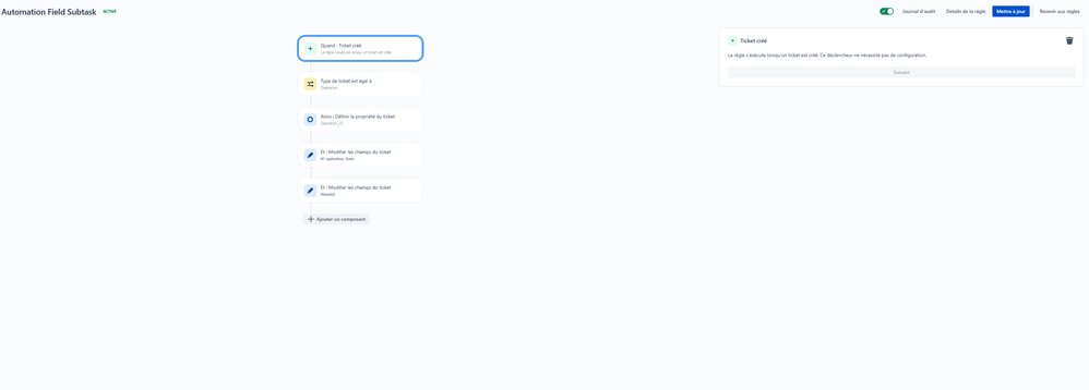

Ahmed Saci
November 1, 2023
Hello everyone @Bill Sheboy @Trudy P Claspill @Matthew , and thank you for your insights.
First, I'll be sharing my automation rule with you shortly to provide a clearer understanding of my current configuration.
Automation Rule Steps:
1-Trigger: Ticket Created
The rule is executed when a ticket is created. This trigger does not require any configuration.
2-Condition: Ticket Field Condition
Check if a ticket field meets certain criteria.
Field: Ticket Type
Condition: is equal to
Value: subtask
3-Action: Define the Entity's Property
Advanced action used to set key-value data pairs for use by other rules, automations, or apps.
Entity Type: Ticket
(Set a property on the ticket that triggered this rule, or on the current ticket regarding a related ticket branch.)
Property Key: Operation_ID
Property Value: "{{#increment}}{{issue.parent.properties.Operation_ID}}{{/}}"
4-Action: Modify the Ticket
Define values for fields concerning the ticket.
Fields to define:
Operation Number: "OP-{{issue.parent.properties.Operation_ID}}"
5-Action: Modify the Ticket
Fields to define:
Summary: Work Card: "{{issue.parent.key}} | OP- {{issue.parent.properties.Operation_ID}} | {{issue.summary}}"
To address Bill's question: the sub-tasks are added manually. The primary reason I want each sub-task to have a unique identifier such as OP-1, OP-2, etc., is for operational efficiency within my company. These identifiers serve as a crucial tool for distinguishing between different operations tied to a task. It's essential for our workflows and processes.
The incrementation should be tied specifically to the parent ticket, i.e., the main task. For clarity, if there's another separate main task and I create sub-tasks under it, I expect the same pattern to emerge with identifiers like OP-1, OP-2, and so on, starting from OP-1 again. It shouldn't continue the incrementation from a different task's sub-tasks. This distinction is vital for our operational clarity.
Thank you for taking the time to assist. Your expertise is highly valued, and I look forward to your suggestions.

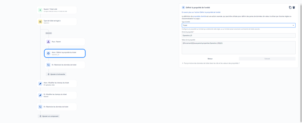

Bill Sheboy
November 1, 2023
First thing: when using the Issue Created trigger, I recommend always following that with the Re-fetch Issue action.  This trigger can fire so quickly that the data is not available for later rule processing, and the re-fetch will slow the rule by about one second and reload the data before proceeding.
You rule is using an entity property for the "counter", stored on the parent of the trigger issue.  When you want to increment that value, the rule must first branch to the parent issue, to perform the edit.  Otherwise you are adding that property to the trigger issue.
Next, after you increment the property, there are two things to consider:
  1. When a rule makes a change to an issue (particularly the trigger issues), those changes are not yet visible to the rule...they are only stored in the Cloud.  Adding a Re-fetch Issue action will reload the data before proceeding after an edit.
  2. When you edit the trigger issue to add the parent's entity property, I do not know if that is visible.  Please test to confirm it is.  If not, you may use a work-around by loading the parent issue into the Lookup Issues action to access the property.
Ahmed Saci
November 2, 2023
Hi @Bill Sheboy
Thank you for your prompt response and detailed instructions
I followed the instructions provided, but it's still not incrementing correctly. Every time I create a sub-task, it always sets the value as OP-1.

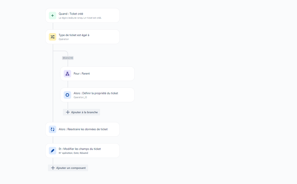

Bill Sheboy
November 2, 2023
The re-fetch issue action must be outside and after the branch to reload the data for the trigger issue.
Ahmed Saci
November 3, 2023
Hi @Bill Sheboy
No its not Work . in the same issue Parent if I create a sub-task A the value  OP-1  and a subtask B it always sets the value as OP-1
Bill Sheboy
November 3, 2023
I just noticed an error in your increment, smart value expression...When you increment the value, the branch is already to the parent.  And so the smart value should be:
{{#increment}}{{issue.properties.Operation_ID}}{{/}}
or more simply:
{{issue.properties.Operation_ID.asNumber.plus(1)}}
