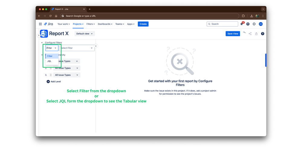

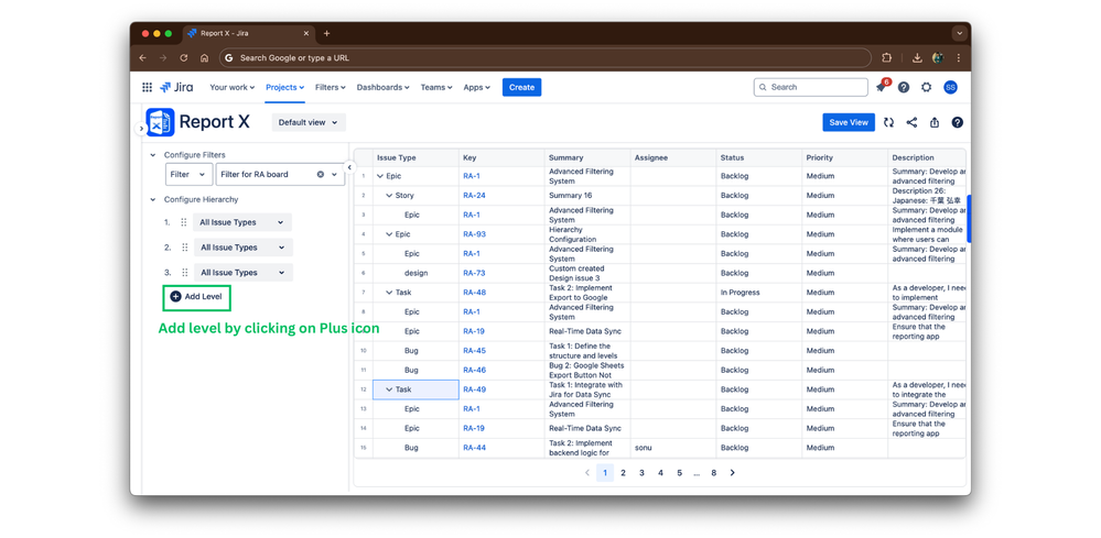

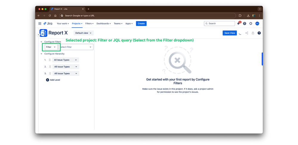

I’ve been looking into a solution that might help with this. It’s called Report X - Multilevel Traceability Report, and it’s made to work with linked issues and hierarchical workflows.
This tool makes it easier to work with linked issues and hierarchical workflows by letting you query across multiple levels (like Bug → Root Cause → CRB/Replacement → Maintenance). It also shows you clear visualizations of issue relationships and gives you reports to analyze dependencies—all without needing complicated JQL.

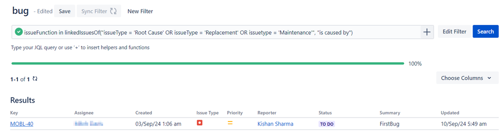

You can use below JQL in ScriptRunner Enhanced Search, to identify Bugs, which has linked issues.
issueFunction in linkedIssuesOf("issueType = 'Root Cause' OR issueType = 'Replacement' OR issuetype = 'Maintenance'", "is caused by")

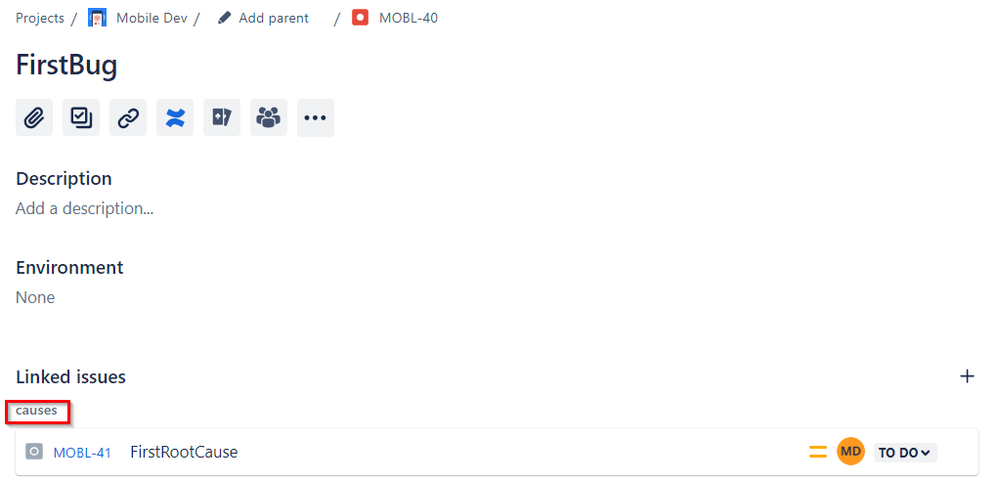

In my example, I have a Bug
which is linked to a Root Cause
When I run the earlier shared JQL in ScriptRunner Enhanced Search, I get below output -
You can save such filter and use it to find related Issue Types.

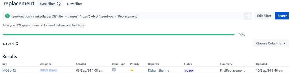

For example, below query finds all Replacement
issues that are linked to Root Cause
issues, using the link type "fixes".
issueFunction in linkedIssuesOf("filter = causes", "fixes") AND (issueType = 'Replacement')
