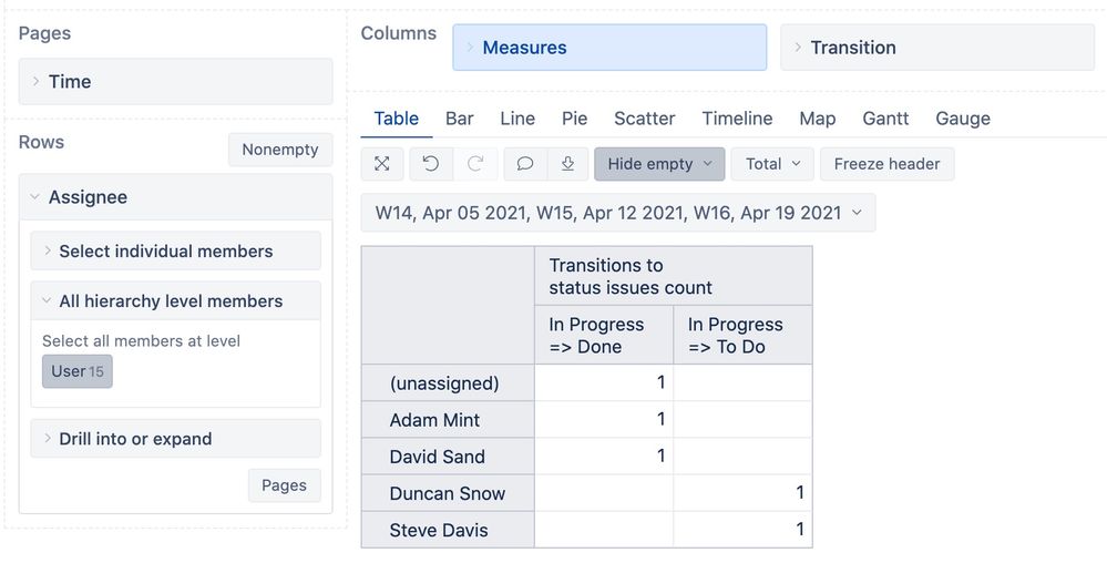

Thank you so much Bill. It helped me to run the different JQLs in extract the reports in JIRA. How can we get these reports in EazyBI? Is there a way to have the measures or Dimensions?
Thank you.

Janis Plume (eazyBI)
April 23, 2021
Hi @CHANDRASEKRAN THIRUMALAISAMY
It is possible to create such a report with the standard building blocks of eazyBI (i.e., with drag-and-drop. The report could look like this:
You may wish to check other options of how to build the reports on the Demo account of eazyBI:
https://eazybi.com/accounts/1000/dashboards/14871-chart-types

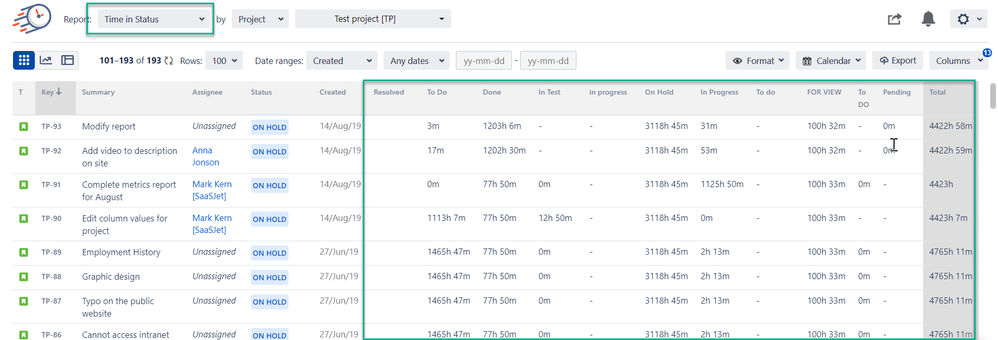

You can try Time in Status for Jira Cloud developed by my SaaSJet team. It generates reports based on statuses.
A Time in Status report shows time an issue has been spent in each status (Ready to "In-progress" or "In-progress" to "Test-Ready").
An Assignee time report shows how long each Assignee has been assigned to each issue.
A Status Entrance Date report shows a date that an issue has entered each of the statuses.
Hope you find it helpful.
Best regards, Mariana

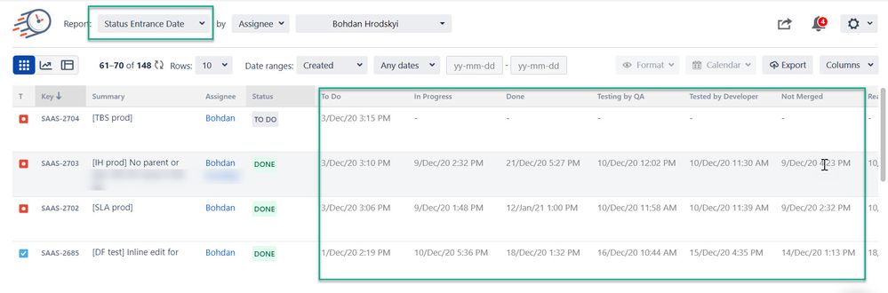

Mehmet A _Bloompeak_
Atlassian Partner
April 25, 2021
Hi @CHANDRASEKRAN THIRUMALAISAMY ,
As an alternative, you can try Status Time app developed by our team. It provides reports on how much time passed in each status as well as status entry dates and status transition count. The reports are based on history of issues and you can trim the history range.
Once you enter your working calendar into the app, it takes your working schedule into account too. That is, "In Progress" time of an issue opened on Friday at 5 PM and closed on Monday at 9 AM, will be a few hours rather than 3 days. It has various other reports like assignee time, status entry dates, average/sum reports(eg. average in progress time per project). And all these are available as gadgets on the dashboard too.
Here is the online demo link, you can see it in action and try.
If you are looking for a free solution, you can try the limited version Status Time Free. Hope it helps.
