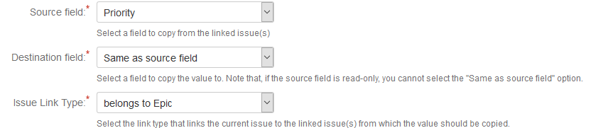

Some workarounds could be designed, based on adding the following post-function (natively included in all Jira Cloud instances): Copy field value from linked issues (JMWE app)
Please, note that the workaround wouldn't be elegant nor a good practice.

The Destination field could be changed to a new custom field, created for that specific purpose, so that tasks could have different priorities than the epic they belong to.
The workaround could be set in a quite satisfactory way, though it would require a quite long explanation. I'm thinking of writing an article about it... I'll let you know once it's done! ;)

The solution I was thinking of would be the last use case in the article, applied to the Priority of the Epics (see Use case: Edit permission on the field level), so that the Priority could only be edited by executing a transition.
Add the post-function Copy field value from linked issues (JMWE app) to the same global reflexive transition in order to synchronize the Epic's Priority field with the Epic Priority field in its stories.
Please, note that the mere act of adding a Story to an Epic wouldn't set its Epic Priority field, but the Copy field value from linked issues (JMWE app) post-function could be added to all of the Story transitions to force a refresh. Besides, using the global reflexive transition in the Epic can modify the Epic Priority of all its stories.
