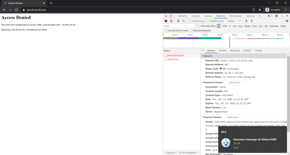

Hi @Petter Gonçalves , I met the same issue, blank page.
Then the worst thing is that if I refresh my page I get an access diened returned and have no way to login again.
I have try to clear browser cache, clear cookie, incognito mode with no help.
Any idea how to recover the login to work ?

Hello @serge calderara
It seems you are facing a different error than the one described in this issue.
This issue is specifically about the dashboard view as a wallboard, however, it seems you are facing a login/permission error by your description.
Can you please provide us with a screenshot displaying the error of "Access denied" you are facing together with the URL you are being redirected when this error is reproduced?
Also, check if any additional details of the error are returned in the development tools of your browser.

hello @Petter Gonçalves here is the screen shot
thanks for help, I hve also about a ticket at atlassian support (GHS-193086) with no answer yet..
I have noticed that after different retry on clearing cookies and reboot, I get back finally my login after different attempt.
But need to know why going to this dashboard view is causing this
