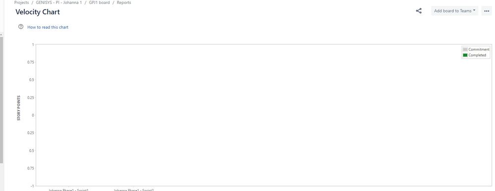

I have multiple sprints sets in my project and some of the sprints have been completed. When i try to pull the velocity report, it comes empty. Please assist.

@David Ansari - can you share a screenshot here, please?

@David Ansari - can you confirm if any of the sprints contain pointed stories? That is, do the issues in those sprints have values in the Story Points field?
If not, what you're seeing is correct.
If so, that's definitely not good!

@Dave Liao Yes, the stories have value point.

@David Ansari - can you confirm what the JQL is for your board's filter?
(Feel free to anonymize the names of projects, or any sensitive info.)
David Ansari
May 22, 2023
Did you mean this: project = GPJ1 ORDER BY cf[10007] ASC

@David Ansari - that looks correct!
(On your board, you'd click "..." then "Board settings" then "General" (if you're not on that section), then look at "Filter query")
David Ansari
May 22, 2023
Thats what it shows me. Just not sure why the velocity is blank. Any idea how i can go about fixing this?
