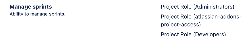

I have "Manage Sprint" permissions assigned to the project roles of "Administrators" and "Developers," and yet users with these roles are not able to create a new sprint. They are able to edit existing sprints, but they need a Jira admin to create the sprint, which is cumbersome.
Does anyone have advice for how to ensure the correct team members have permission to create sprints?

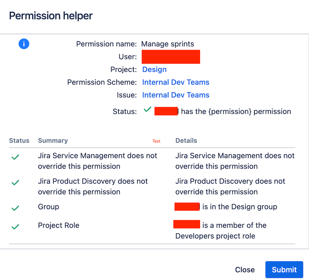

On the Permissions screen for the project, click the "Permission Helper" link in the upper right corner of the screen. It should bring up a window where you can enter a user, a Jira issue number, and then select "Manage sprint" for the feature. It will tell you why or why not that person can perform the action.

Shannon Smith
July 9, 2024
I checked all that. But this only checks for "Manage sprints" permission, which they do have. That's why I think something is overriding the "Manage sprints" permission when people try to create a new sprint. (It's weird because they can still start, end, and edit a sprint.)

Shannon Smith
July 9, 2024
100% sure. I also logged in as a project Admin and Dev in order to verify that those users don't have the option to create new sprints. Here are screenshots from the Project Settings pages for "Permissions" and "People."
