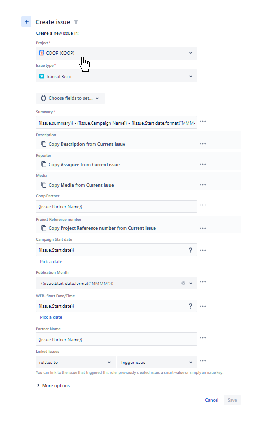

I have added an automation rule to have a link created with the trigger issue (the one I'm working on) and it is not working. Can you help me understand what I'm doing wrong? Is it due to the order of the fields?Jira issue.png

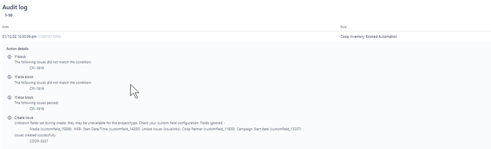

Whenever you have a question about an Automation Rule, please show use the entire rule, and also show us the details of the audit log for the execution of the rule.
Also, explain exactly what is not working. Is the new issue getting created, but no link set? Is the new issue not getting created at all?

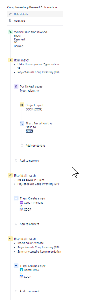

Hello Trudy, thank you for your reply and the suggestions. Please find the build of the automation as well as the audit log. The ticket is getting created but despite my request to have a link created (relates to by trigger issue) the ticket does not have a link. Thank you for any suggestions you may have.

That rule structure and the error message seem to indicate you are trying to set fields in the issue create which do not exist for that issue type: Transat Reco

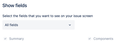

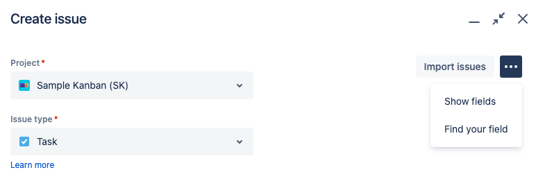

If they are not displayed, check Show Fields and make sure all the fields are displayed.
Screen Shot 2022-12-22 at 9.53.08 AM.pngScreen Shot 2022-12-22 at 9.53.16 AM.png
If the fields still don't show, then they probably have not been added to the screen used to create that type of issue.
You can check that using the Find your Field option shown in the first image above. After selecting that, enter the name of one of the fields. This is a sample of output.
