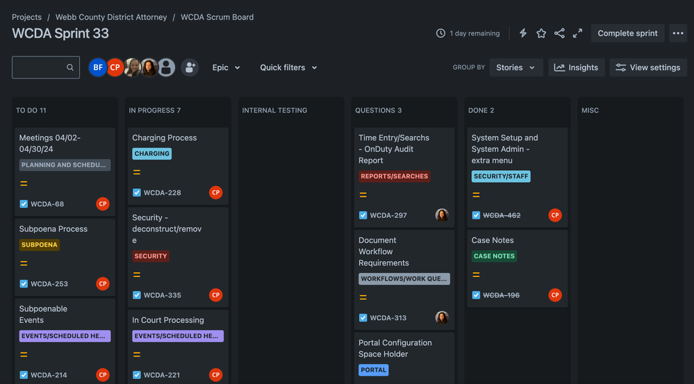

The Query is being used on this board.

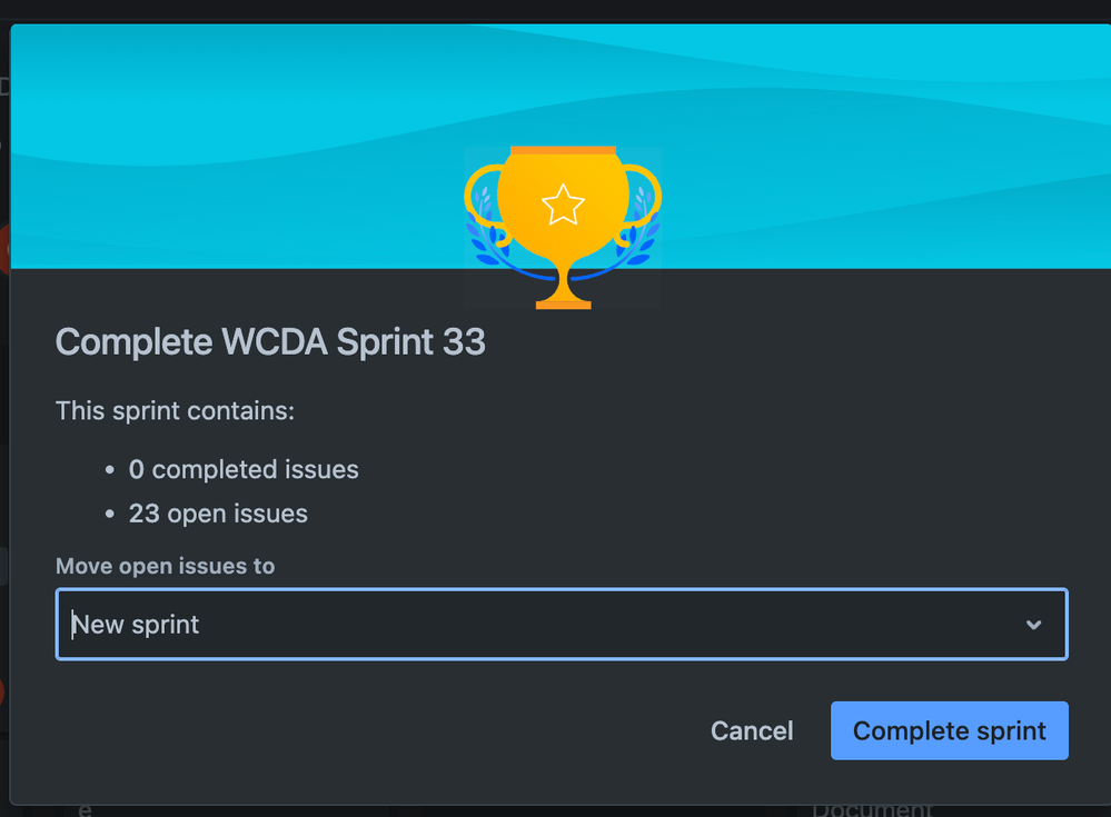

When we try to complete the sprint it shows 0 done but the tickets are assigned to the sprint

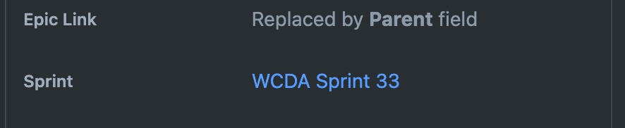

This screenshot is from one of the done tickets being shown on the board

Upon completion of a sprint only the issues in the column farthest to the right on the board will be considered "complete". It doesn't matter what the actual status of the issue is. It only matters if that status is mapped to the column farthest to the right.
Based on your screen image, only issues in the MISC column would be considered complete at the end of the sprint.
You need your DONE column to be moved to be that column farthest to the right.
If you need issues in multiple statuses to be considered complete at the end of the sprint, then all of those statuses need to be mapped to the column farthest to the right.
