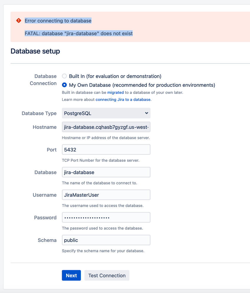

I have installed Jira software on an EC2 linux machine and have created a RDS POSTGRESQL. I am able to connect between ec2 and RDS, however while doing the SetupDatabase in the browser, its failing with the message as: at http://10.124.157.124:8080/secure/SetupDatabase.jspa
Error connecting to database
FATAL: database "jira-database" does not exist
I also manually created dbconfig.xml in the location /var/atlassian/application-data/jira/data with my rds details but no luck.
Can you please help as to what I am missing here?

As per the error screenshot it seems database name/or URL which you are providing is not reaching.
I hope you are following the correct format.
for example,
pgm-l4v72fgghjt1ho6vsb194100.pgsql.me-central-1.rds.aws.com:5432/jira-database
For your case the port number and database name will be different, and URL is nothing but the endpoint URL of RDS service.

manisha sharma
April 21, 2023
I am using the same details as you mentioned:
Endpoint
jira-database.cqhasb7gyzgf.us-west-2.rds.amazonaws.com
Port
5432
database name: jira-database

@manisha sharma  is your RDS is using MySQL or PostgreSQL engine and can you please check and try the format i have share with you in my previous comment.
manisha sharma
April 21, 2023
Its PostgreSQL engine.
When you say format, where do I use that because what I can see while setting up and in the screenshot, I am using those details only.
Endpoint is jira-database.cqhasb7gyzgf.us-west-2.rds.amazonaws.com
Port no is 5432
DBname is: jira-database
so, what format should it be. I didnt get you.
Mayur Jadhav
April 21, 2023
can you please try in this format jdbc:postgresql://<rds-instance-hostname>/<database-name>
where replace<rds-instance-hostname> with your RDS endpoint URL and <database-name> with your actual DB name and put this in Hostname in database configuration page?
manisha sharma
April 21, 2023
Thank you, its working now!!
