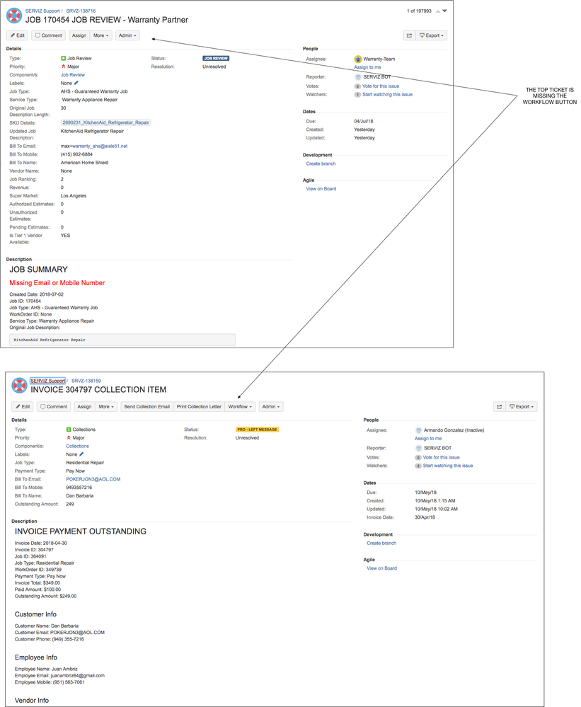

My issue types do not have any workflow options
Max
July 5, 2018
I have double checked the workflow, issue schemes, and run the integrity checker.  I still can't get the workflow options to show up.

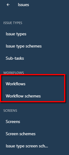

Are you talking about the ..
Issue view screen workflow option
in Admin-->issues --> Workflow option
Can you please attach the screenshot ..for where this option you want to see.
Max
July 5, 2018
The "Workflow" button is missing.  I created a board and can't transition the ticket to any workflow steps.  Basically this ticket type is not recognizing the workflow that is assigned to it.
We have done the following:
Double checked that the issue type scheme is published
Double checked that the workflow is published
Double checked that the issue workflow scheme is published
Ran the integrity checker
Re-indexed
