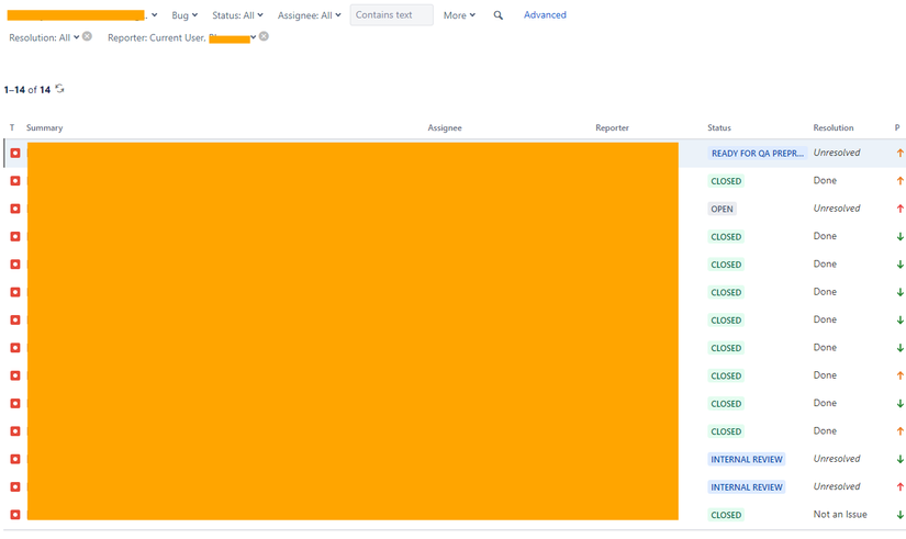

Kateleen Ah
August 29, 2018
From the filter also, I cant see the Closed/Resolved issues:image.png
But I filter by the Person who logged the issues on this specific Sprint, i do have the Real total number of issues logged for the specific sprint.
But this wont work all the time as my team members works on different sprints, o it's difficult to really track how many issues were logged on a specific sprint.
Giedre Yager
August 29, 2018
Maybe you could share the Filter Query for your board, it would be easier to say if there is smth that should be adjusted.

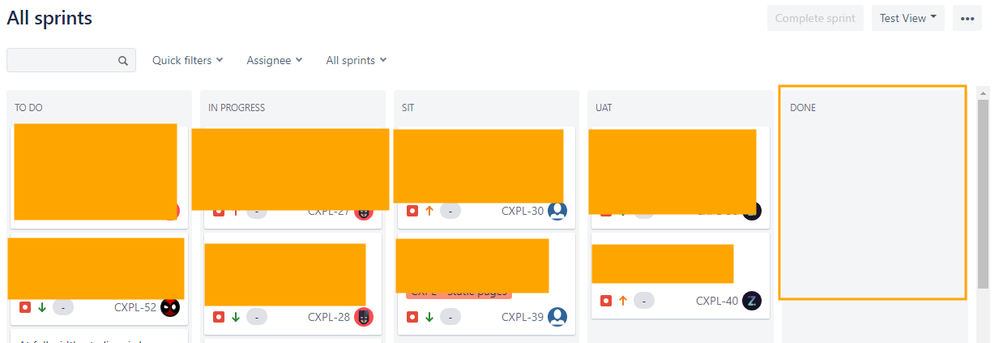

Kateleen Ah
August 29, 2018
Hello,
I see 19 closed issues in the column settings, but they are not displayed on the active board:
Plus when i create a filter for a specific sprint, i dont get the closed issues.
Nic Brough -Adaptavist-
August 29, 2018
That tells us that they are not in the current sprint.
The reason the board mapping says "19 closed" in "done" is that it does not look at sprints, it just shows you every issue that matches the status.

Kateleen Ah
August 29, 2018
Once an issue is drag in the DONE column, we have a popup to put the resolution of the issue (That's how our workflow works). Once set, wont it be remove from the sprint and never actually display in the column?
Yes, you are right, i just need my closed issues from a sprint to remain in the sprint :)
I'm just curious to understand the logic of the done column since it wont show anything, It's only use will be to transit issues.
August 29, 2018
No.  The "done" column simply holds your closed issues in the current sprint.
The 19 issues you are talking about here are no longer in the sprint, so they do not appear, although we would expect them to (I do not know why you've removed them, it's not the right thing to do)
