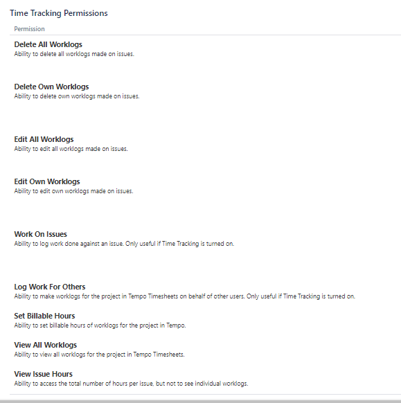

as you mentioned to look for  Find the "work log" section, but instead i found these options, !  Which one to followworkLogIssue.png
Nic Brough -Adaptavist-
April 7, 2021
"Work on issues" in the middle of the list is the one.  It says "Ability to log work done against and issue" under it.
