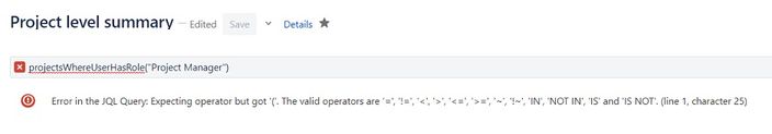

I can't seem to get correct syntax using the JQL you provided, but that looks like exactly what I need.

Could you please provide a screenshot of the "user and roles" settings for the project and the query you used so we can fix the syntax? :)
Rich Gold
February 14, 2018
Query I'm attempting to write for this filter:

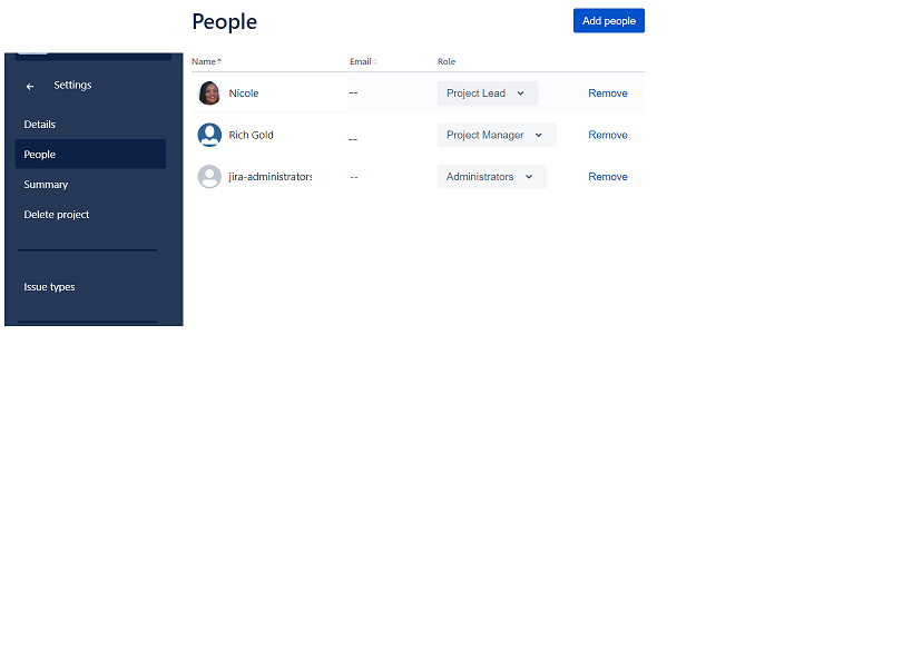

Roles page within project settings (I believe this is part of Tempo add-on):Screenshot - Roles.png

Hey Rich,

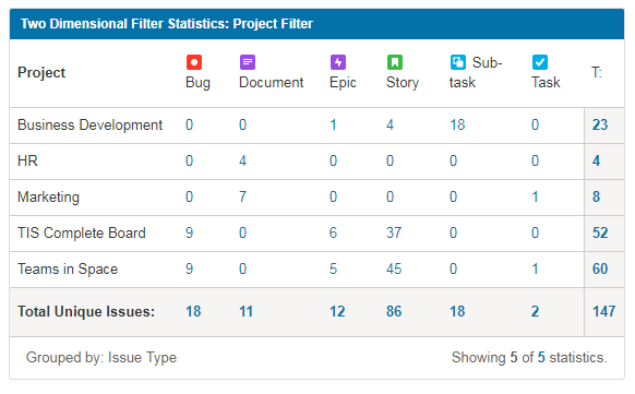

sorry for that. I got you wrong from the beginning. So just to have a list of your projects is (from what I know) not possible. I think you could write an own Gadget for that if you want to. But you can get around that a bit with using a 2-Dimensional Filter Statistics Gadget and using the following JQL query (the problem with the query is of course that it will list all issues of the projects where you have the role.)
project IN projectsWhereUserHasRole("Project Manager")
Configure the Gadget to use the filter and let the y-Axis be "Projects" and in my case the x-Axis is "Issue type".
So you see your projects in general and can but (on the other axis) some interesting data you might want to see as well. Here's my example:

Within a project settings, there is a "people" screen where you can assign roles. I want to create a filter based on those role assignments.
Rich Gold
February 13, 2018
Those roles may be from the Tempo plugin, so I'm wondering if I may not be able to use them in filters?
