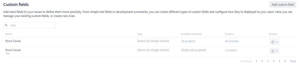

Hi All,
I am using custom field in my Jira instance, Actually, these two fields are grayed out I am unable to Edit or Configure the fields as it's showing grayed out.
Could you please let me know the process, i want to configure the field and add the field values?

Hi @Andrews  - Do you have any idea what the id is for the custom field that you created? Do you use it in any Automation or other place that you might have the id?
Andrews
June 16, 2020
Hi John,
Yes, i know the Root Cause field id cf[10904] . I am using Script Runner and JMEW addon but i have not done any automation or post function with the Root Cause field.

John Funk
June 16, 2020
Then go into the Configuration for a field that you can get to.
Once there, replace the id for that field in the URL with 10904 and see if it will let you get to the configuration that way.
Andrews
June 16, 2020
Hi @John Funk - Noted... Thanks much I missed this key point. I am able to view the configurations and context of the field.
Thanks for your quick help.

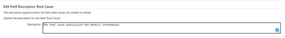

Have you done any Javascript in the field description or announcement banner?
Andrews
June 16, 2020
Hi @Mathis Hellensberg  - No, I haven't done any JavaScript in the description and announcement manner.
Now the field is grayed out so how can i check the field description??
Andrews
June 16, 2020
@Mathis Hellensberg - I have checked in the field configuration. There is no JavaScript in the field description.
