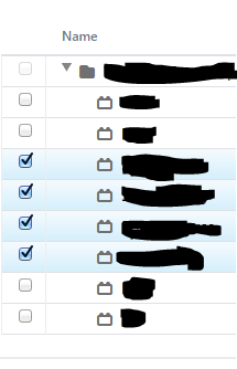

1. Create a Story meant for multiple components (seen as sub-domains) -> components symbol -> selecting components. For example, C, D, E and F.

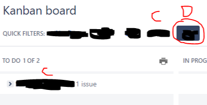

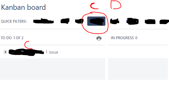

2. Going back to the Board, only the first selected component is visible as swimlane C (swimlanes are defined as component = Name ). The problem is, two sided:
I. As the story is meant for multiple sub-domains, the same Story should be visible in multiple Swimlanes C, D, E and F and not only in C.
II. Quick Filters are also set-up (as component = Name). When you filter on C, C is appearing. When you filter on D, the story and swimlane for C is appearing. Same for E and F: the filter is working correct, but everything comes under the swimlane for C.

The short answer to
>How can I make a Story visible in multiple Swimlanes, where by creation I checked multiple components?
Is that "you cannot".  You are not missing anything, everything you have found is correct.
The longer answer does not change that, just tries to explain it a bit.  Swimlanes cut across a board, selecting things to group together by a metric other than "status" (you can still use status, but you get a really unhelpful board).
In most cases, a swimlane is used to represent a single-value metric (project, assignee, story, priority, etc), but when you have multiple metrics in them, it is horribly confusing for humans to see any issue more than once.  We just don't cope with "I did something to an issue in swimlane 4, why has swimlane 1 changed?".
To avoid this, Atlassian simplified.  An issue appears only in the first swimlane that currently selects it.  ("First" as you go down the list of swimlanes - people instinctively put the most important swimlane as the top row)
