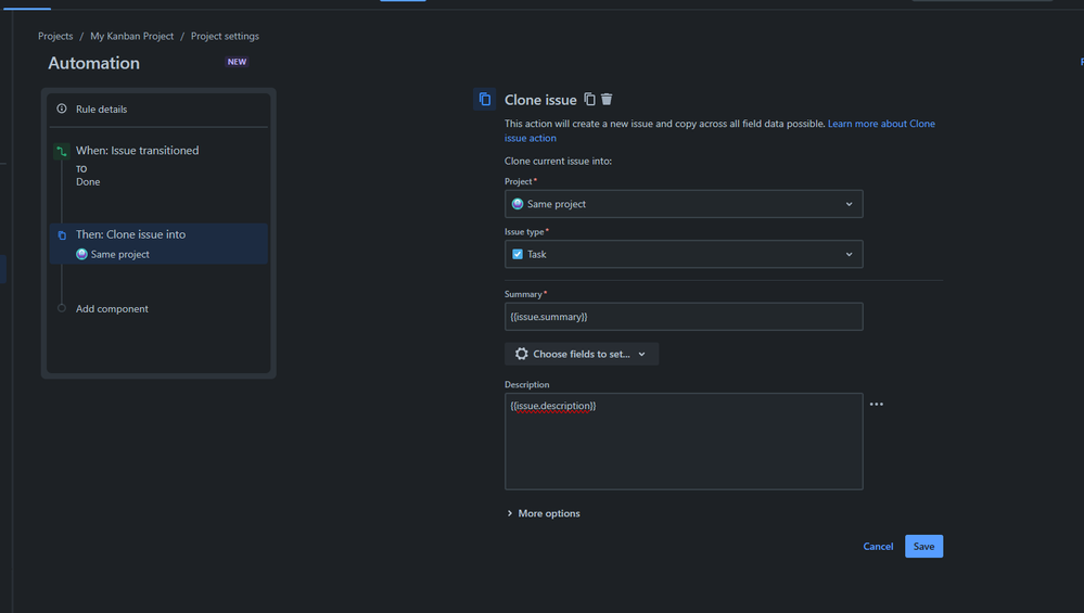

I have multiple automations that I build myself for cross project collaboration or deferring issue types to another team.
I accomplish this myself by use of workflows. I am a fan of cloning the issue rather than moving the issue out of the project completely so that you dont lose out on the information and history of where the ticket started. I also develop statistics for how many tickets teams deffer to each other for purposes of improving workflows, communications and training.
Instead of workflow being "Done" is usually build a workflow that says "Move to "X" team"
When cloning an issue, you are allowed to select the project that it is clone into. [A different project than originally exists in]
A couple of things I do is make sure to set the field description as {{issue.description}} so that the body of the ticket comes across as well.
You also have to make sure that the issue type you are setting the issue that is copied over to also exists in the project that it would be going to.
One of the things I do as well is set the linked issue to link itself to the trigger issue.
