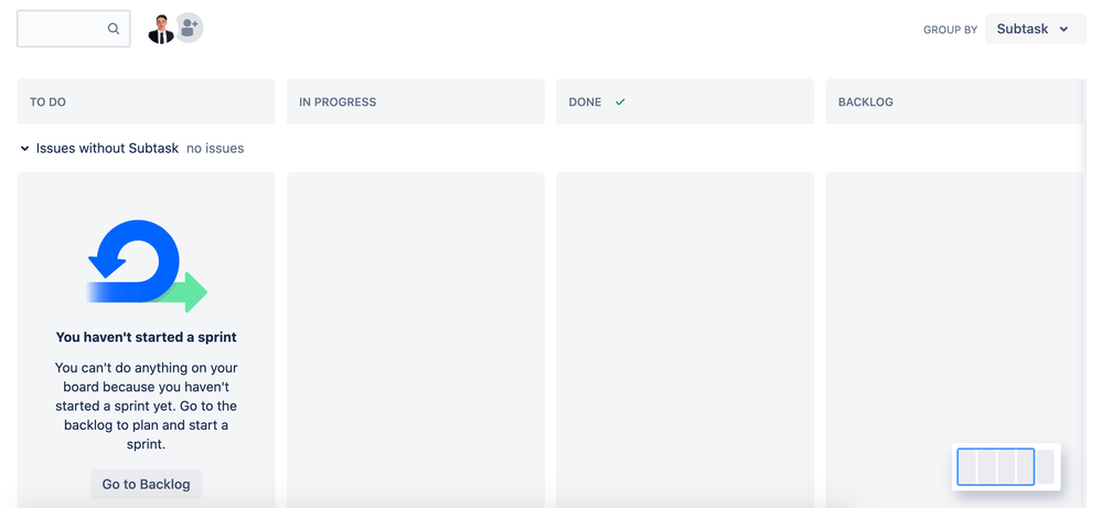

darren.lee
February 4, 2021
So i dont have an Active Sprint section but i do have a Board which shows the tasks which are in the current sprint.
I have not started the second sprint yet since i want to make sure the first set of tasks are completed correctly.
Ste Wright
February 4, 2021
Hi @darren.lee
It is on this Board view that Done has to be the furthest-right column.
At present "Done" is in the middle based on this screenshot - if you click on the column header you can drag "Done" to the right-hand side (past all the other statuses).
You might also want to reorder or delete some statuses in general - for example, "Backlog" would usually come before "In Progress".
Ste
darren.lee
February 4, 2021
Fantastic that has worked thank you! They have all moved to Completed.

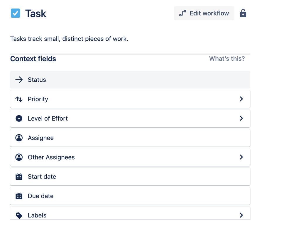

darren.lee
February 4, 2021
On the ticket? I dont have a resolution filed. I have looked in project settings and it doesn't appear to be there. is it called resolution field in next gen?

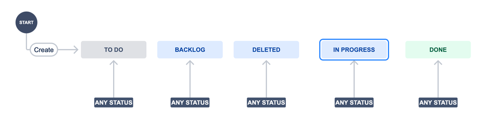

darren.lee
February 4, 2021
So I've changed the workflow now and the DONE status has been moved to the end of the board, it was previously the second last column!
However, as a result the tickets have still not been moved to Completed.
I've also changed the status from DONE back to IN PROGRESS and then back to DONE, yet it still hasn't moved the ticket to Completed.
It could be something to do with the tickets transferring from Sprint 1 to Sprint 2? Regardless it should be appearing as Completed in my burndown report
