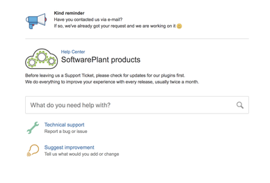

Cool,
then here you can reach them directly: https://softwareplant.com/jira/servicedesk/customer/portal/1
just sign up and you can add it as a feature request :)

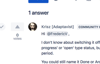

Krisztian Kovacs
August 31, 2018
There should be a greyed out tick next to the answer:
You can either vote for an answer or accept it. Voting is useful when there are different answers and accepting it shows that the issue is resolved basically.
