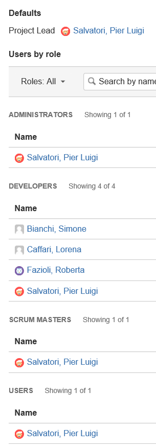

Pier Luigi Salvatori
March 9, 2019
My roles on this projects are: Administrator, Project Lead, Scrum Master, Developer and user (see file attached). So this seems ok.Scrum Roles.PNG

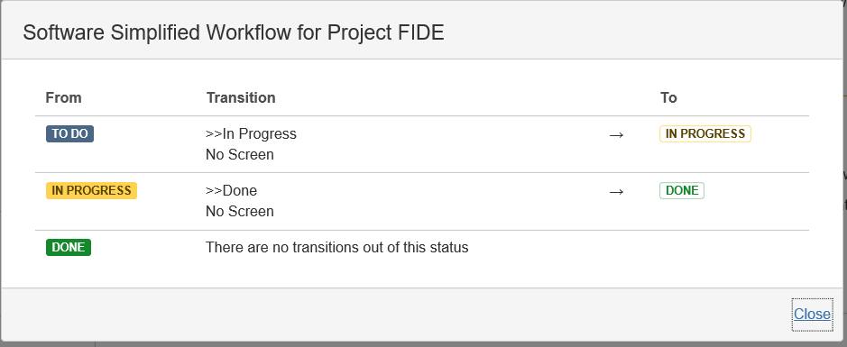

March 10, 2019
And the workflow seems to be ok, too (see picture attached).

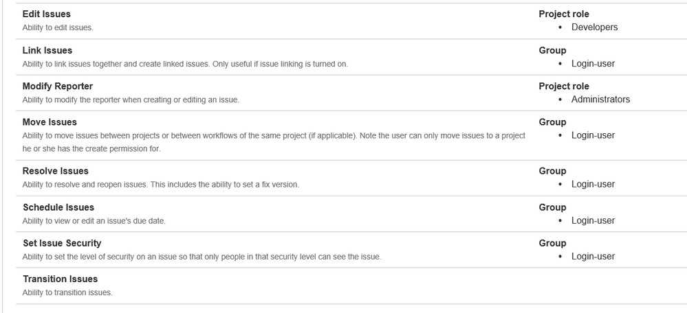

March 10, 2019
Probably I found the problem (see the picture "Transition". It seems that I don't have a permission to transition items in the workflow. If so how can I have this permission? Can I do it by myself or do I have to ask to Jira administrator?Transition.PNG
John Funk
March 11, 2019
Yes, that is what Dharma and I were referring to up above. Yes, you have to be an administrator to change those settings.
