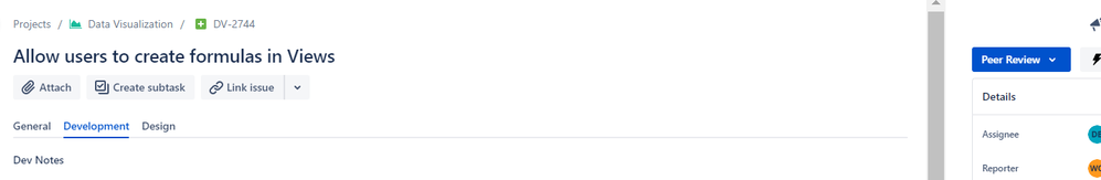

I'm trying to move one of my New Feature JIRA ticket to Build state from Peer Review State.
My Issue is, I have updated all the available fields present in the ticket.

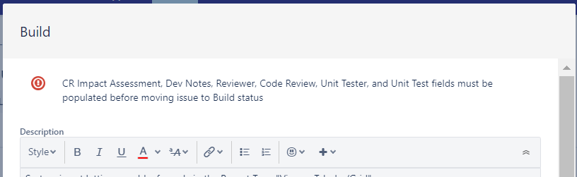

But still it is asking to enter the value for CR Impact Assessment field.
When there is no section of Change Request is present for New Feature, how can we enter value for CR Impact Assessment field?
Can you please help me how to address this?
Please find the attached screenshots for the reference.

Hi @Dadapeer P B,
You need to check your workflow, based on the error message you have validators on the transition to Build status that makes those fields required. So you could either remove those validators, or add the fields to the screen used for New Feature.
