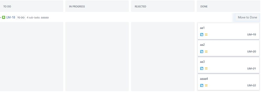

Please can you help me with this task. I can't find how this bug was resolved.
Move to done appear when all subtasks are done but story is in to do status, we want this button (move to done) appearing only when story was finished.
It will be great if you can help me.

First of all, thank you so much for your quick response to my question. Maybe I explained it wrong let me try to explain step by step
Lets say a story is being created, it is in progress status, subtasks are created inside it.
Let's say all the subtasks have been resolved, but the story is still not considered finished because he still hasn't passed the test. But since the subtasks are solved, "Move To Done" appears.
I want that when the story goes through all the stages, "Move To Done" appears and not when the subtasks are done.
I found the link that I posted on the Internet and it described the same thing that I needed, but I did not see a description of the solution there.

There is a comment on the issue you linked that says it was not working in Jira Cloud in 2017. I have actually just tried to implement this in Jira Cloud and found that it doesn't actually work.
If it did work you could implement this by having a separate workflow for your Story issue type than for your Sub-task issue type, and configuring that workflow in a way that blocks the transition of the Story to a Done status unless it is currently in the "test" status.
Unfortunately when I tried exactly that the Move to Done button was still displayed, even though the workflow would not allow the transition of the Story to Done.
