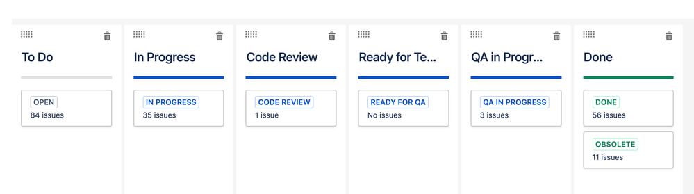

I have two statuses in the far right hand column of my project board.
  • Obsolete
  • Done

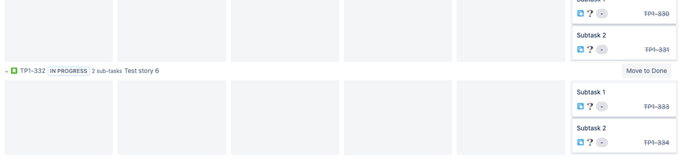

For some reason the Move to Done button only appears on the board when obsolete is in the far right hand column. What setting controls this button?
If I click Move to Done, the ticket gets moved to Obsolete, which is not what we want. How do I set it so that if someone clicks that button, the ticket moves to Done?

I've figured this out and it was more obvious than I suspected. I thought it was to do with some settings on the transition, but in actual fact it was because when a story ticket is In Progress, the workflow doesn't currently allow it to move to Done at that point. The only option is Code Review or Obsolete, so clicking "Move to Done" moves it to Obsolete as that's the only viable option in the last column.
Now corrected.
