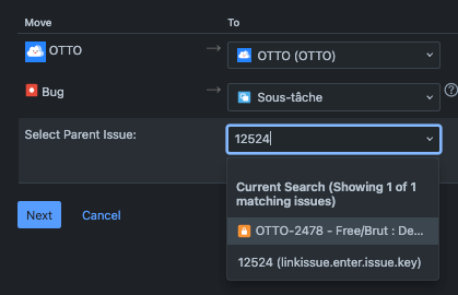

Since Friday it seems we're encountering an issue on our Jira board.
We're not able to move a task to a sub-task
With the ID of the parent issue -> no suggestion the issue does not appears (only old issue already closed)

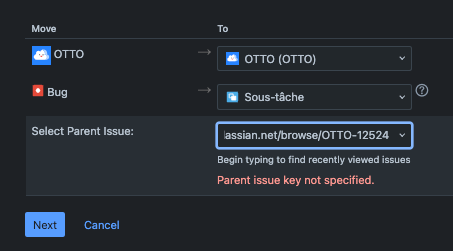

With the link of the parent issue -> Error message sayin it does not exist Capture d’écran 2023-12-04 à 11.40.25.png
Are we the only one to fce this issue ? We used to move tickets every day I don't understand what I am missing here to make it work

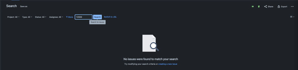

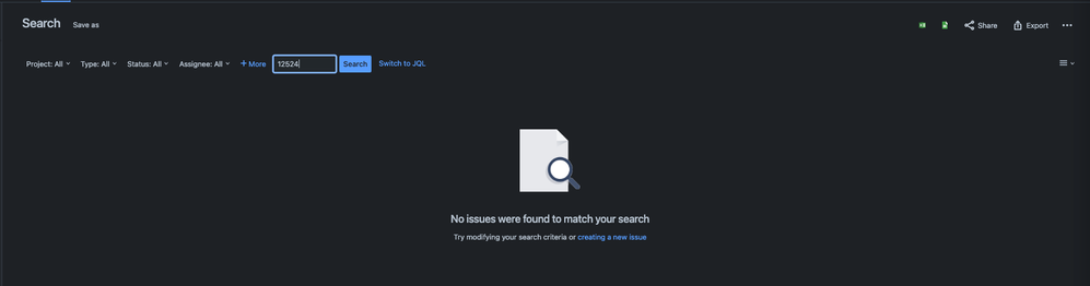

thank you for the answer, it is odd, I can not see the 2 issues in this view.
12524 -> should be the parent
12666 -> should be the sub-task of 12524

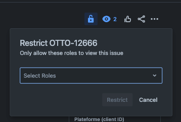

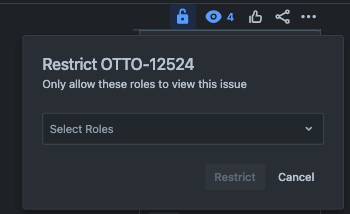

What is weird is that I am the admin on the project and it seems there is no restriction on both tickets
Capture d’écran 2023-12-04 à 12.09.06.pngCapture d’écran 2023-12-04 à 12.09.10.png
I modified the reporter to be me, but still nothing changes, I did move in the past tickets I did not created myself.
Where would I've been able to see those ticket imply restrictions ?

@Oceane RoyerI don't think that typing the number of the key in the search bar will show you the issue. Try this JQL search instead :
key = OTTO-12524
Anyway, It seems that the two last screenshots show that you can access the tickets (you will be able to confirm it by applying the JQL search above).

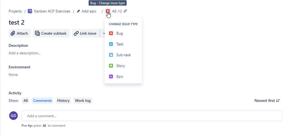

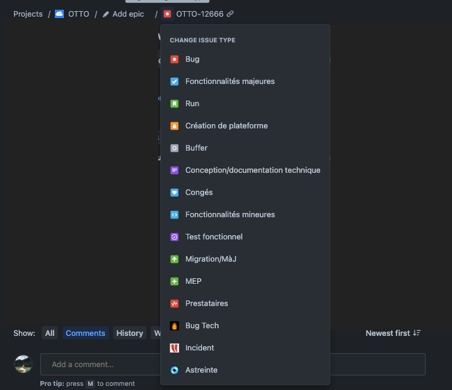

The problem may be linked to the move operation. Try to go to your ticket's view and click on the issue type icon to change it :
If you have the right permissions (browse project permission + move ticket permission -> You should have them by default by having the project administrator role). You should be able to perform the operation.

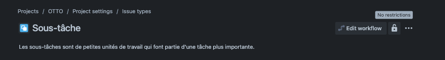

From the issue itself the subtask does not appear, I check in the project settings and the issue type exist and has no restriction...
Capture d’écran 2023-12-04 à 14.30.15.pngCapture d’écran 2023-12-04 à 14.31.11.png
I can open an issue to Jira cause it never happened before

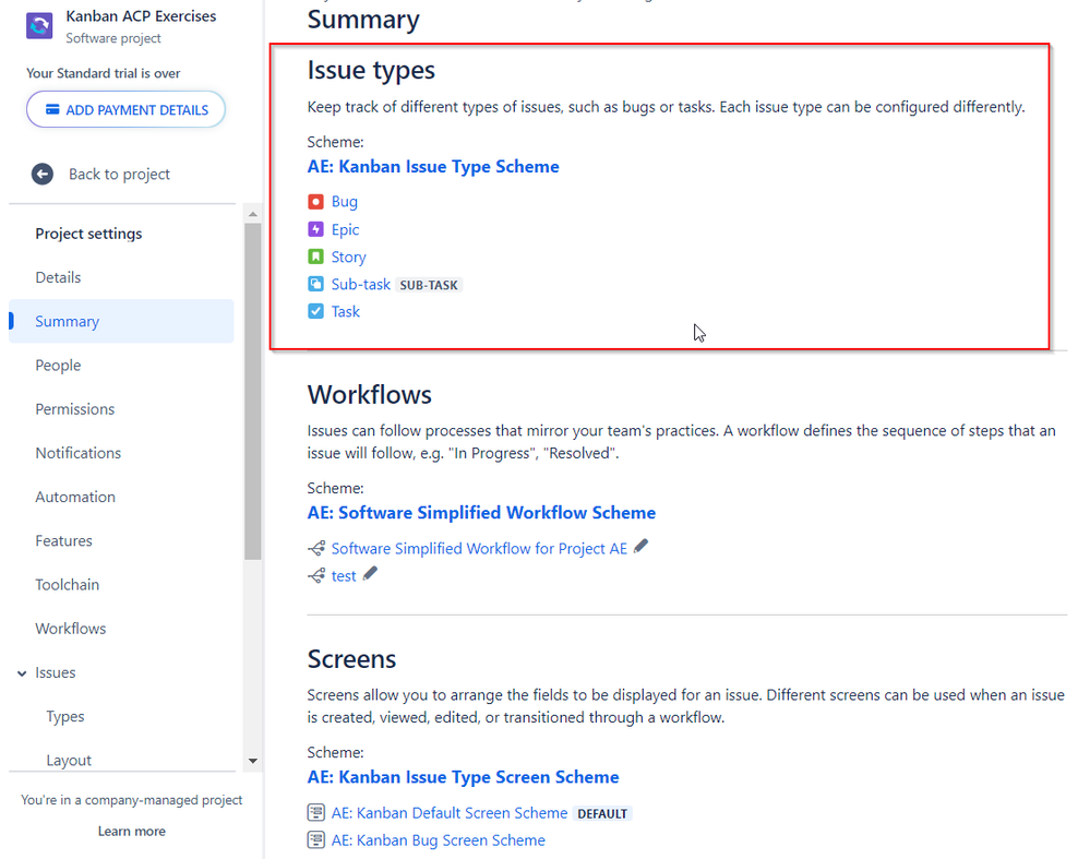

Cela me semble étrange que vous n'ayez pas la possibilité de changer votre issue type vers les sous-tâches alors que les autres changements sont représentés. Peut-être que celles-ci ne sont pas représentées dans votre issue type screen scheme ?
Vous pouvez le consulter dans projet settings (menu déroulant à gauche) puis summary.

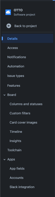

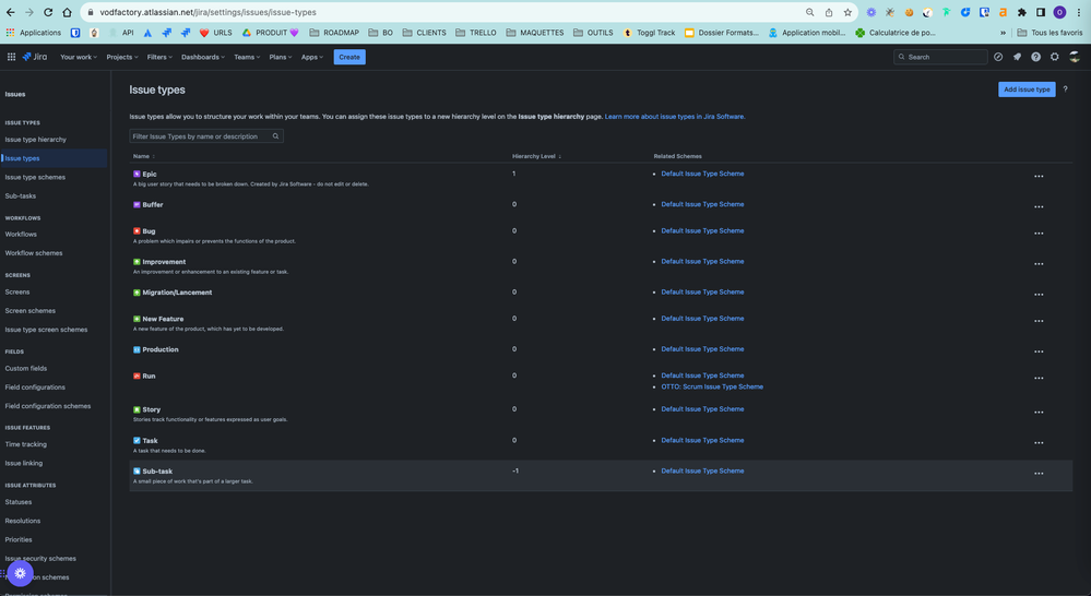

@Gauthier Docq Merci encore pour ces informations, je n'ai pas summary dans cette vue il s'agit bien des Project settings de Jira pas d'Atlassian ?
Ici la capture de Project Settings où nous n'avons pas le summary
Ici les paramètres Issues d'AtlassianCapture d’écran 2023-12-04 à 19.14.52.png

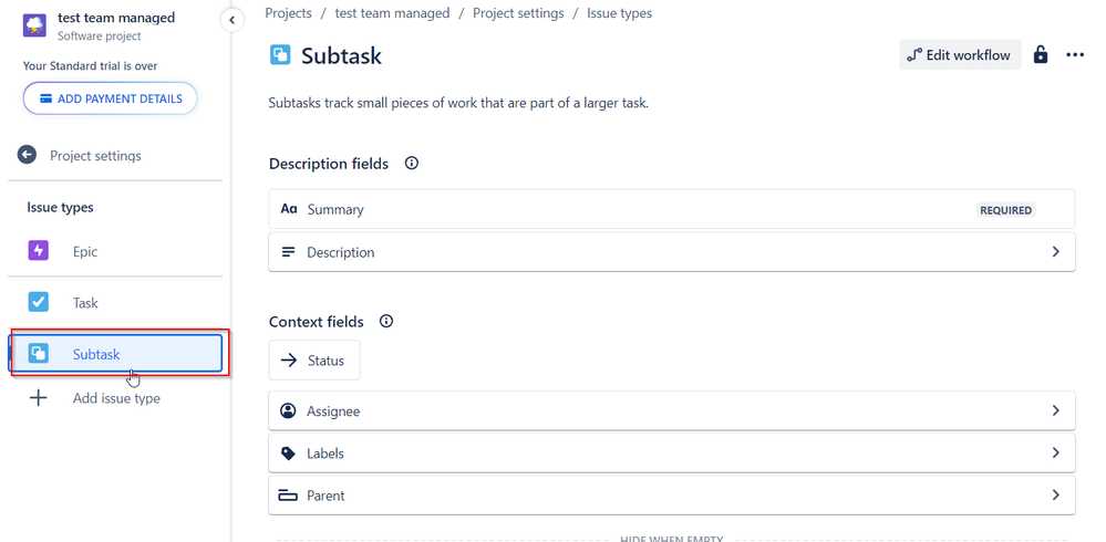

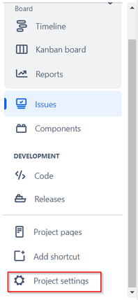

Je parlais en effet des paramètres de votre projet Jira Software. Cependant, vous n'avez pas accès à la vue l'onglet summary car votre projet a été créé en Team-managed. C'est une option qui vous est proposée à la création de votre projet Jira Software. Vous pouvez vérifier à tout moment dans le coin inférieur gauche de votre écran sur quel type de projet vous êtes en train de naviguer.
Contrairement aux projets company-managed, les projets team-managed comportent des fonctionnalités plus simplifiées et configurable projets par projets. Si vous souhaitez continuer à travailler sur ce même type de projets, ne considérez donc pas ce que je vous ai indiqué précédemment par rapport aux différents schemes qui, eux, sont appliqués dans les projets company-managed.
Je suis personnellement moins habitué aux projets de type team-managed car ils sont beaucoup moins utilisés, mais il me semble que vous pouvez procéder comme ceci :

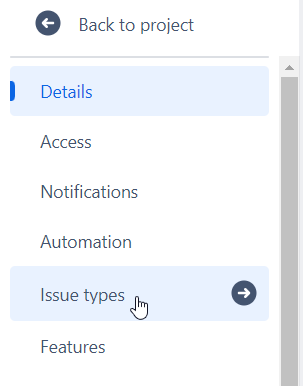

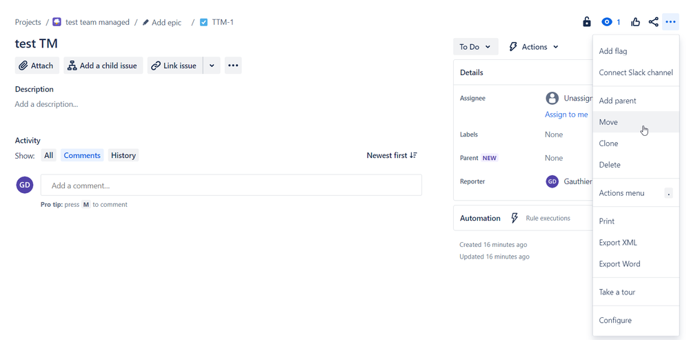

Dans project settings, cliquez sur issue types
Vous devriez être en mesure de vérifier si les tickets de type subtasks sont disponibles dans votre projet.
Si c'est le cas, vous devriez avoir la possibilité de convertir votre issue type via l'option Move disponible en cliquant sur les (...) en haut à droite de la vue de votre ticket.
